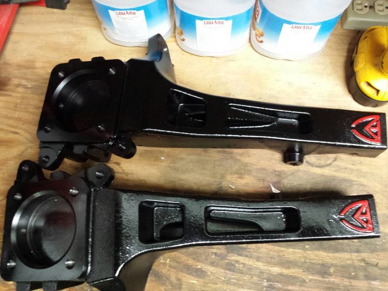

    yes, i painted all the bare metal surfaces too. i only masked the cup where the wheel bearing slides in.

    Ok, that you. How long did it hold up? Any issue with the paint being too thick in areas?

    its been a little over a year since, still looking good. as far as install i had no issue with paint interfering.

    @ChadsPride I paint a everything & have had no problems. I tried not to paint where the bearing goes but got some over spray in there, was too lazy to tape it off. Haha

    I don't see why not, I just used Rustoleum & it's held up fine, probably cheaper too. If you're already buying the caliper paint then try that.

    Yeah that should look good, i know a that had his powder coated white to match his truck. I was gonna powder coat mine but the cost compared to spray paint is ridiculous not to mention his powder coating was cracking & rust was starting to bleed through. The big thing is to get them painted with something cause they're iron & will rust in no time.

    Sorry for late reply, some people work around here. :rofl:Chad, use whatever you want. As long as it's covered. I used 1 coat primer, 2 coats matte black, 1 final coat semi gloss. I used rustoleum however I hate the new nozels they use. Must be a Cali thing. As the others said tape off the bearing part. Blast the rest. Here's mine after 2yrs. I have OCD though and I constantly am wiping shit down.
