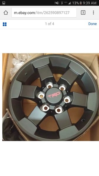

    The ones I'm looking at are on craigslist. But those the wheels

    Here is a pic of my truck with FJ wheel . Perfect fit no spacers needed.

    Sweet thanks! What's your setup??

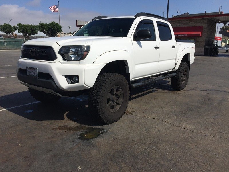

    Of course man, can you post a pic of your rig? I like pics
    Yea I had just finish washing her
