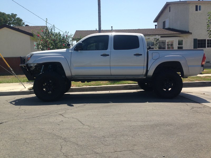

    Yotamac
    Yotamac Well-Known Member Vendor
    Mar 30, 2013
    #100909
    1,336
    Ze
    562- Cerritos, CA
    07 PreRunner
    Stuff, stuff and more stuff
    The kings do add lift, mine added about 2.5" of lift
    IMG_5333.jpg .
    JoseyWells, BigJQ55 and ChadsPride like this.
  7. Aug 31, 2016 at 7:41 PM
    #8247
    Addicted2Pomade
    Addicted2Pomade Well-Known Member
    Jun 1, 2016
    #188493
    178
    Eddie
    Socal
    2010 Super White Tacoma Long travel
    Did it add 2.5 with the spindle lift? So you're at 6.5?
    ChadsPride likes this.
  8. Aug 31, 2016 at 8:11 PM
    #8248
    Yotamac
    Mar 30, 2013
    #100909
    1,336
    Ze
    562- Cerritos, CA
    07 PreRunner
    I think its less then 6. I have a skid plate and tube/ plate bumper up front too.. It has settled a little and will settle probably some more.
  9. Aug 31, 2016 at 8:22 PM
    #8249
    Addicted2Pomade
    Jun 1, 2016
    #188493
    178
    Eddie
    Socal
    Do you have any preload on your kings?

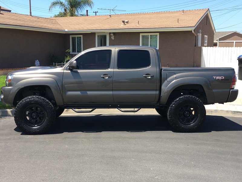

    BigJQ55
    BigJQ55 Well-Known Member
    Jul 2, 2016
    #191097
    51
    Jason
    North Texas
    2009 Double cab Tacoma Trd Sport
    In the works
    Here's mine
    spindles, billies set at .85 and full Dakar leaf pack with extended 5100's and 285 k02's. Sits about a half inch higher in front
  11. Aug 31, 2016 at 8:26 PM
    #8251
    tacoma09medic
    tacoma09medic ParaPUP09
    Dec 10, 2012
    #92843
    197
    Tom
    Franklin
    2011 Taco, 4 inch lift, 315/70/17, all-pro armor front and rear, ARE Z series, bed lights, Tint, Rigid LEDS
    To much
    Hell yea bro. Looks SICK.
    ChadsPride and BigJQ55[QUOTED] like this.

  13. Aug 31, 2016 at 8:32 PM
    #8253
    BigJQ55
    Jul 2, 2016
    #191097
    51
    Jason
    North Texas
    In the works
    I would think set at 0 with the bumpers you have, you will definitely get some major rubbing. I didn't trim anything and I get rubbing in reverse at full lock, easy fix just haven't had time to do it yet.
    That being said I have stock bumpers and that's where it rubs on the front of the fender lining. But with the weight might be hitting your cab mount.

    07 PreRunner
    I haven't adjusted any preload. This is how they came from King. Only thing is I have #650 coils instead of the standard #600 that Kings normally ship with. King OEM's ship with around 2.5" of lift over stock.

  16. Aug 31, 2016 at 8:55 PM
    #8256
    Addicted2Pomade
    Jun 1, 2016
    #188493
    178
    Eddie
    Socal
    Alright thanks man, I have kings with 600 lb coils and I'm installing some maxtrac spindles soon but I might lower the preload on mine.
