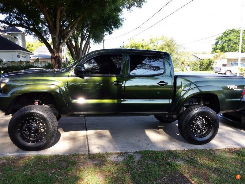

  12. Sep 11, 2016 at 3:31 PM
    #8312
    Krog
    Krog Well-Known Member
    May 27, 2014
    #130737
    128
    Keith
    Florida
    12 TRD Sport DCSB
    Maxtrac spindles, All-Pro offroad leaf springs, 285-70-17 nittos, avid offroad steps
    @SpruceTaco, truck looks good! Did you go higher cause you were rubbing or just to go higher? I'm trying to figure out if I'm going be able to fit some 285-75-17 on my truck with maxtracs and ome 884's? I'd be at about 6" if I leave my billies at 0. I've got 285-70 right now but the 75's are a 34" tire but actually a little skinnier than my current tires. I've got cab mount chop plates just in case but I'm trying to keep from cutting too much plastic.
    ChadsPride and SpruceTaco like this.
  13. Sep 11, 2016 at 4:21 PM
    #8313
    SpruceTaco
    SpruceTaco トヨタ
    May 18, 2012
    #79082
    12,271
    Clearwater, FL
    2012 Spruce Mica TRD Sport
    Tinted windows 5%, sill protectors, TRD stubby antenna, weathertech in channel rain guards, wheathertech floor mats, BHLM, Truxedo low pro qt, DTRL deleted, anytime backup camera, bed storage locks, fog lights on anytime, tailgate theft deterrent, painted engine cover, relocated horns, l.e.d bed lights, l.e.d engine bay lights, l.e.d lights above cup holders, in glove box, rear cup holder, in console storage & cubby next to steering wheel, Grillcraft grill, 17x8.5 SCS Ray10's, 35x12.50 Nitto Ridge Grapplers, Borla cat back exhaust, map & dome l.e.d's, TEQ badge on grill, Redline tuning hood struts, Maxtrac spindles, SPC Light Racing UCA's, Bilstein 5100's front set at 0 with OME 885's & extended length Bilstein 5100's in the rear, All Pro expedition leaf springs & 2" blocks, extended brake lines front & rear, 1.5" 4crawler drive shaft spacer, Beefed Taco carrier bearing drop, 1.25" spidertrax wheel spacers on rear, Kenwood DNX570 touchscreen with navigation, 30" led light bar in lower bumper opening, 1/4" top plate spacer drivers side, Bullet Proof Fabricating skid plate, Cali Raised ditch lights & Rago f Fabrication brackets, Amp Research power steps, smoked l.e.d 3rd brake light, Wet Okole seat covers, under cab LED'S tied to dome circuit
    Thanks! I went higher for both reasons. It settled about 3/4"-1" & was a touch low in front. It also rubs the cab mount but only when the cab is full of people so I wanted to try going all the way up first & putting it at 7", if it still rubs I'll do the cmc. I've already trimmed plastic in front of the wheel & behind the wheel.
    I had 285's on a 3" lift originally. Then I changed my whole lift to basically the set up I have now but with my billies at 1.75 so for a while I had 285's with 5.75" lift & no rubbing at all. I'll find some pics for you.
    White Horse likes this.
  14. Sep 11, 2016 at 4:35 PM
    #8314
    SpruceTaco
    SpruceTaco トヨタ
    May 18, 2012
    #79082
    12,271
    Clearwater, FL
    @Krog
    285's & 5.75" lift, Maxtracs & billies at 1.75
    tapatalk_1399176475844-1.jpg d53a7952-6100-402e-badb-e91d8398547a.jpg tapatalk_1399176467650.jpg
    LowRpmCruise and White Horse like this.
  15. Sep 11, 2016 at 5:13 PM
    #8315
    Krog
    May 27, 2014
    #130737
    128
    Keith
    Florida
    12 TRD Sport DCSB
    Cool, thanks for the pics and info man.
    I have 285's now but the tires I want are about an inch taller and the same width. They are basically 34" tall so I was curious if you or anyone else that made the jump to 35's thought I could go that big with 5.5"- 6" lift in front without too much rubbing.
    ChadsPride likes this.
  16. Sep 11, 2016 at 5:30 PM
    #8316
    SpruceTaco
    SpruceTaco トヨタ
    May 18, 2012
    #79082
    12,271
    Clearwater, FL
    You're welcome! Until yesterday I was running my 35's with 6.25" & like I said I trimmed plastic & it rubbed on the cab mount occasionally.keep in mind my tires are 12.5 " wide so that also contributes to the rubbing. If you were at 6" I would think you'd be ok. You would be about where I was with the lift but your tires will be an inch smaller(.5" each side of center) & about an inch skinnier. Worst case you'd have to trim plastic & possibly do the cmc.
