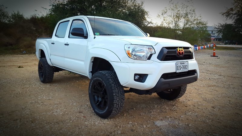

    Thanks

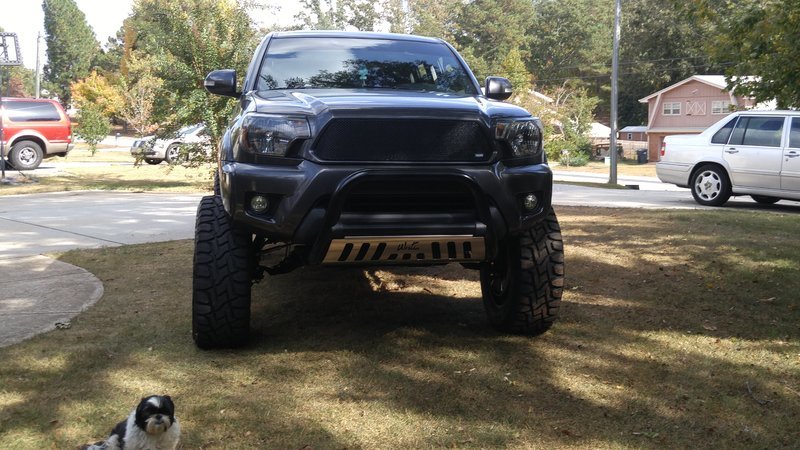

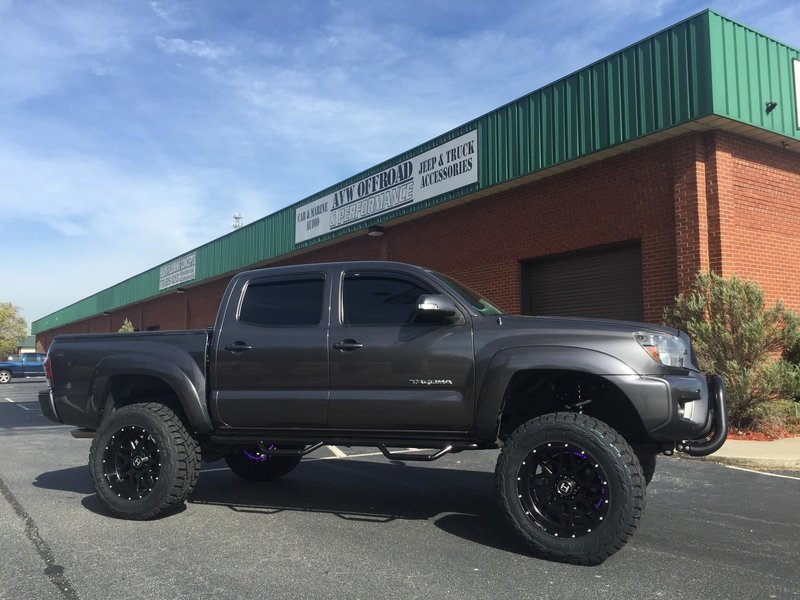

    Maxtrac spindle
    Front Bilstein 6112 clip set on 3rd notch pro comp upper control arm
    4in block in the rear with bilstein shock
    ChadsPride likes this.

    Wheels hostile sprockets 2x10 - 19 offset
    1 1/4 wheel spacer Toyo 1st 35 12.50 201027161513f.jpg

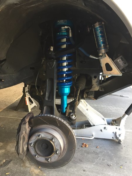

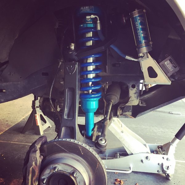

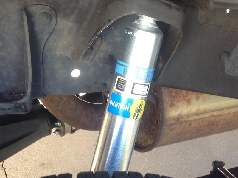

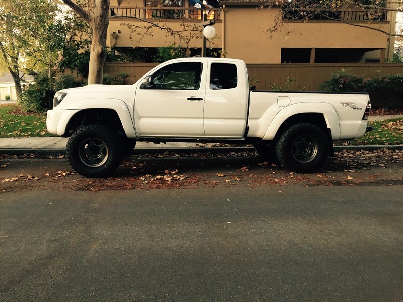

    Talk about hard bro lean... extended travel w/ no pre-load. Yikes! Way too much for me.. i'll be contemplating my next move for the rear.

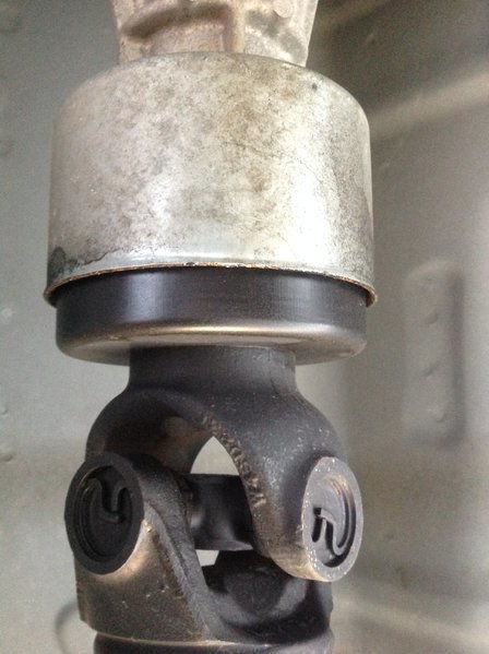

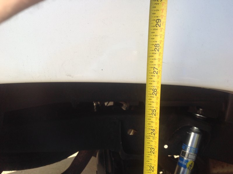

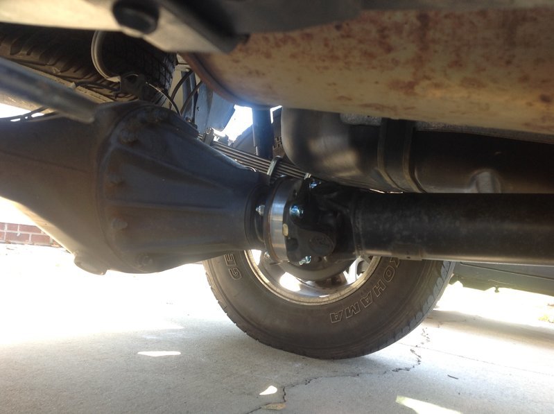

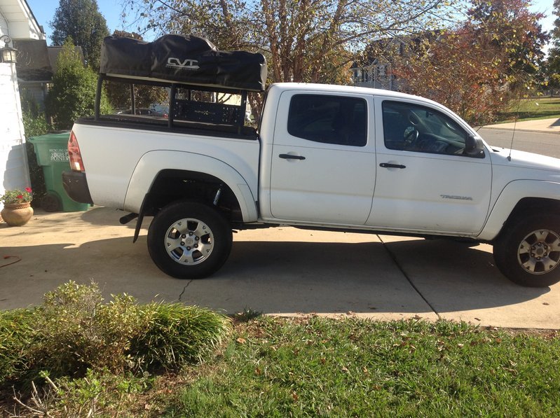

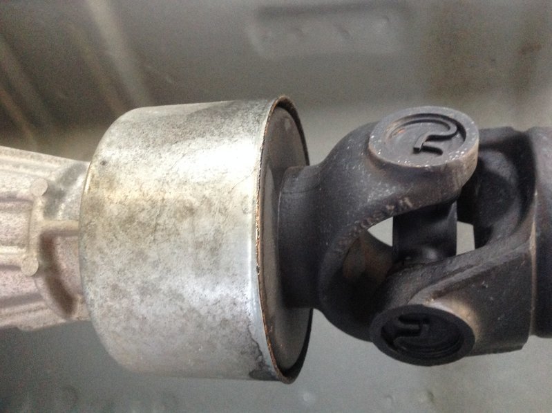

    Rear is done! Dakars plus the dx29l extra leaf, Bilstein 5125s, 3 degree shims, CB drop, and 3/4"DS spacer. And Marie @HeadStrong Off-Road sent me an email after hours on a Friday to let me know my Spindles will arrive Monday! ---NO VIBES

    That's a whole bunch of rake you got there.

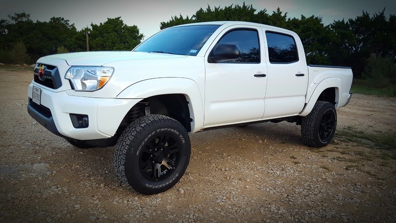

    image.jpg image.jpg Well it's always the case one side goes great the other not so. Only a small hiccup the hard line had bad flare on one end was over tightened, trip to NAPA and $6 later replaced. Then everything else without a hitch. Waiting on some wheels for the 285s sitting in the garage.

    Looks good man!!! What wheels?

    dem tars lukin purty tiny mang

    Yeah they are. Want some 285's. Really wanting a new wheel setup also
