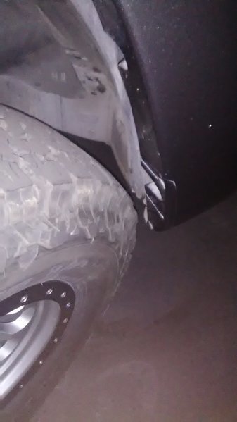

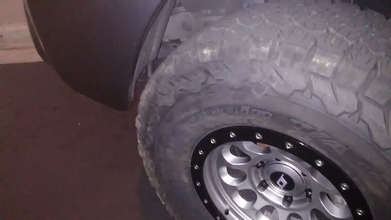

    Thank you! And just realized I had a typo in my original post which I fixed, I have 285/75/r16's which according to the TW Tire Calculator comes out to 32.83". And I trimmed out a piece from the inner front fender-well as well as about an inch from the fender near the cab mount.
    Here's some shitty pics I just took to hopefully give you a better idea of how close it is. At full lock it sits about a 1/2" away on both sides. No problems with rubbing now(city driving).IMG_20161207_170443.jpg IMG_20161207_170322.jpg

    Cool, that makes more sense. I was wondering how you made em fit that easy but since they're 16's that makes a difference. Either way, nice truck. I like those ray 10's, I've got the SR8's and love em.

    Great looking Truck! Really diggin' those wheels! 1/2 is really close to the cab mount. As your suspension settles it may get closer.

    Thank you man! And I'm gonna take care of the pinch weld and cab mount this weekend for peace of mind!
