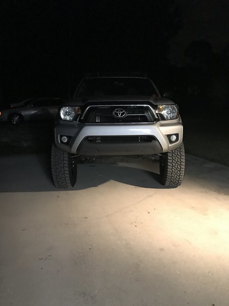

    What a long ass day ! Tackled this install on my own. Took about 10 hours. I have no mechanical skills. Brakes took a while. Had to cut some of the bracket. Was left with a bunch of left over washers and those rubber hose clamps. Not sure where they go. Had to drive home about 80 miles without an alignment. It's sketchy. Seems solid though. I do get the occasional loud clunk when make a hard turn. Sounds like coil moving/ setting ? 5100 @ .85
    Bro LEANNNN hard for now lol

    Completely stock
    Block or leaf pack in rear?
    I'd check that clunk first thing in the morning to make sure everything is good

    Check before. Any small adjustment could throw off the alignment.
    Is thw clunk only when your turning or when you come to a stop?

    Check your upper ball joint and do a once over. Also make sure you flipped the racket pinion to point down and not facing up like it was on the stock spindle.
