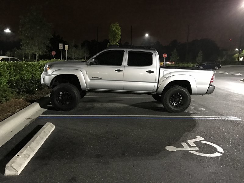

    What would you all recommend to give me a slight rake ? I only have a 2" block. It looks like I need roughy another 2. Has to be some what economical.. or i can wait and keep driving this boat planing off..

    You've got a 2 inch Block in there right now??

    Yes sir. 2" blocks. Doesn't look like it anymore lol

    What did you have besides the spindles? That beast is high af!!

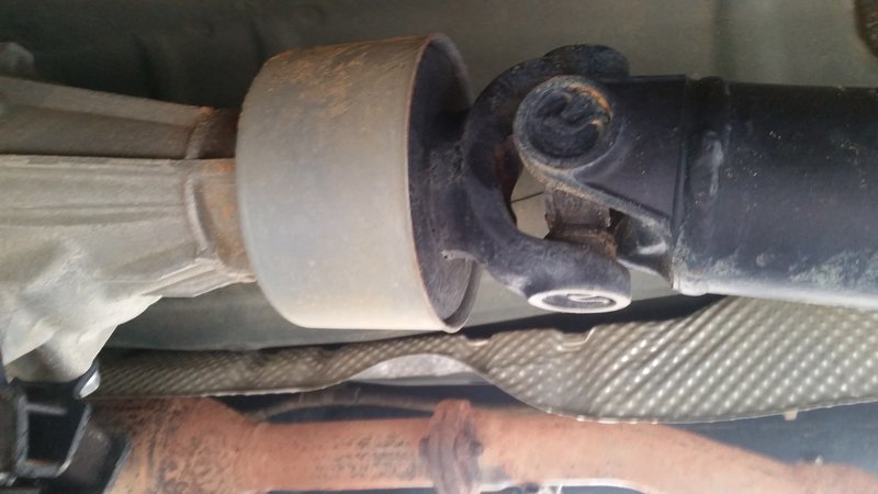

    I still need a stall drive shaft spacer. You can see how it's pulled out almost an inch.

    Where would I be looking exactly to check for pull?

    At the tail of the transmission where the driveshaft goes in.
    This is how it's supposed to look & this pic is after the spacer was installed.
    20151218_112925.jpgthis is how it looked after the lift.

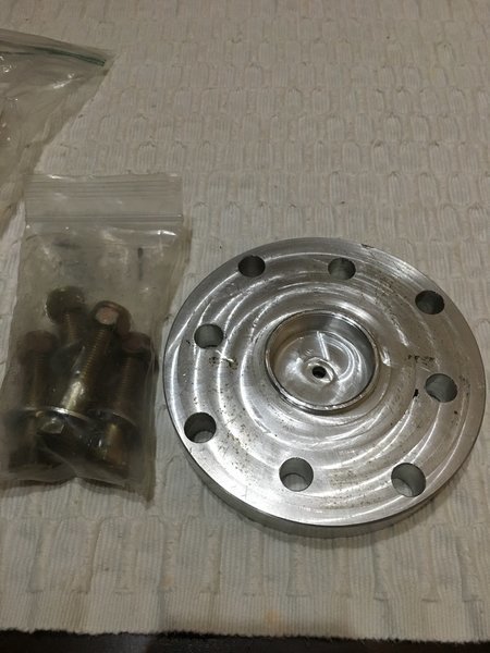

    I've got a 3/4" driveshaft spacer if anyone needs one. Bought from 4crawler but ended up going with the one inch. It's the 66 version that's what my 2012 TRD sport takes. Let me know, will make you a sweet deal cause it's just sitting here. IMG_1380.jpg

    Dang, me wants.

    How much is yours stick out?
