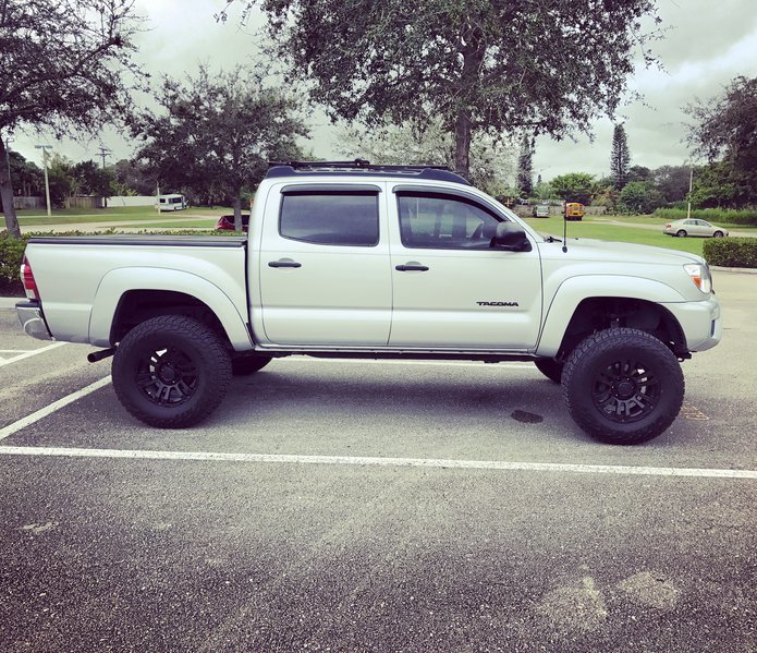

    Guys, my rear drivers side sits about an inch lower than passengers. Already have 1/4" top spacer up front for lean. I've had this before the spindles but now it shows more.
    Rear has 2" blocks. I have my previous 1" blocks in my garage. How bad of an idea is it to put the 1" block on top of my 2" to even it out ? Or is my leaf pack shot ? 2013 with 48k
    Pic of passenger side is close to level. Other side more bro lean

    Nice! 6.5" kit correct? Don't know if anything coming up but I have agreed to host a mod day when Strictlytoyz gets his stuff, just don't know when that will be.
    We can post on here to see if anyone would be up to do it sooner but with the holidays it may be tough.
    https://www.tacomaworld.com/threads/where-are-all-the-tampa-bay-area-people-at.262544/page-405
    As far as the ds spacer I'd hate to say order it & you need a bigger one. It's a tough call

    Leafs are probably clapped out. I would order Dakars so complete the lift properly.

    That's a bad idea, I think you'd be asking for trouble. Have you measured center of hub to the fender on both sides? And if so are you measuring it with the truck on flat level ground? Mine has measured different depending on where it sit in the driveway, I always pull it in the garage to measure.

    When you you measure, do you just run the tape measure across the tire to bottom fender or?
