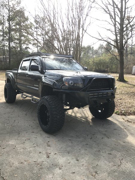

    Dang man!!! Thats a really nice truck!
    Who made that bumper?

    One of my buddies here in my home town. Has a custom shop and everything at his house. Built it right up on the truck in a day

    WOW!!! Thats bad ass, it looks awesome man!

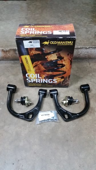

    So you have a toytec spacer lift & the bilsteins? I'd pick one or the other but not both. I think if you max out the billies & have a spacer you'd be at 5" & the uca's will be hitting the coils, if not real close. I have my billies maxed with the toytec 1/4" spacers to make an even 3" & my 35's don't rub. I'm about to install 885's hoping to get some ride quality back & still maintain 3".
    Also look at Light Racing uca's, they have dual adjustability so you can fine tune your alignment. They allow you to adjust caster or camber & not mess up the other. Usually adjusting one messes with the other.
    I ordered the 885's & Light Racing uca's from HeadStrong.

    Springs or uca's?
    I have both but haven't had a chance to install them yet.

    Don't be like Chad. :rofl:I hear ya man I got shit piled up on the work bench as well. Busiest time of year at work for me. I should read your posts better. Lol. I new you ordered UCAs. You should be much more solid down the road. You guys doing a mod day?

    Yeah I'm on vacation but life gets in the way. Haha
    Not for this, I'll probably knock it out in the next couple days before my vacation ends.

    Pics pronto!
