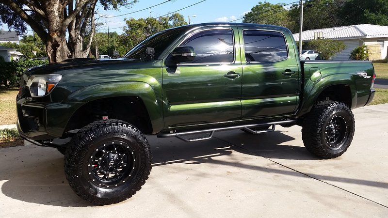

    Tinted windows 5%, sill protectors, TRD stubby antenna, weathertech in channel rain guards, wheathertech floor mats, BHLM, Truxedo low pro qt, DTRL deleted, anytime backup camera, bed storage locks, fog lights on anytime, tailgate theft deterrent, painted engine cover, relocated horns, l.e.d bed lights, l.e.d engine bay lights, l.e.d lights above cup holders, in glove box, rear cup holder, in console storage & cubby next to steering wheel, Grillcraft grill, 17x8.5 SCS Ray10's, 35x12.50 Nitto Ridge Grapplers, Borla cat back exhaust, map & dome l.e.d's, TEQ badge on grill, Redline tuning hood struts, Maxtrac spindles, SPC Light Racing UCA's, Bilstein 5100's front set at 0 with OME 885's & extended length Bilstein 5100's in the rear, All Pro expedition leaf springs & 2" blocks, extended brake lines front & rear, 1.5" 4crawler drive shaft spacer, Beefed Taco carrier bearing drop, 1.25" spidertrax wheel spacers on rear, Kenwood DNX570 touchscreen with navigation, 30" led light bar in lower bumper opening, 1/4" top plate spacer drivers side, Bullet Proof Fabricating skid plate, Cali Raised ditch lights & Rago f Fabrication brackets, Amp Research power steps, smoked l.e.d 3rd brake light, Wet Okole seat covers, under cab LED'S tied to dome circuit
    I've seen a guy with white ones.
    I painted my MT red, it's still visible.
    With 285's.
    With 35's

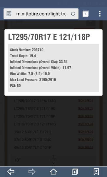

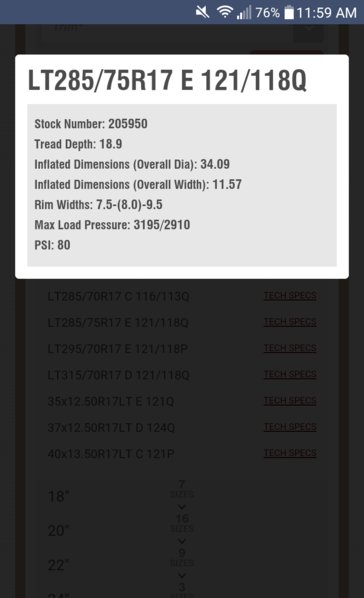

    295/70/17 or 285/75/17 trail grapplers?
