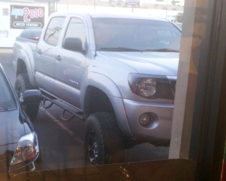

    markmatters
    markmatters [OP] Viejon
    Nov 4, 2011
    #66436
    1,311
    Mark
    Yuma, AZ
    2007 PreRunner
    I installed the beefed 1.5" drop...driveline looks hella straight...u-joints were replaced a couple of months ago...im still vibing...at this point..i just ignore it. Or try to... :)

    Used to get the shudder when the vehicle starts rolling...now i get the 20-25 vibes...its hopeless hha...
    And a little update...dont give me shit for doubla parking...it wasnt my fault haha..
