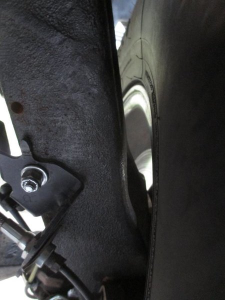

    I'm pretty sure spacers will be needed, @Alfuh has 16's with 4.5" bs if I'm not mistaken.

    yeah you'll need spacers to run those steelies. I know without my spacers my 16x8s fit, but barely, probably about 1/2" to spare between the wheel and spindle. You will have to do spacers on all sides. you could do the 1.25s up front and a set of 2" in the back if you are looking for even track width

    not much room lol
