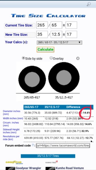

    Last time I checked I got 17.8 on about 50/50 city/highway & 20 straight highway. That's with me factoring in the size difference of 14.6% because you actually travel farther than the odometer says. 35's are 14.6% larger than stock. So it's odometer reading + 14.6% ÷ number of gallons to fill the tank.
    My tires are also pretty light for 35's at 65 lbs compared to like Toyo MT's at 83 lbs.
