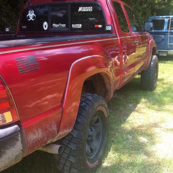

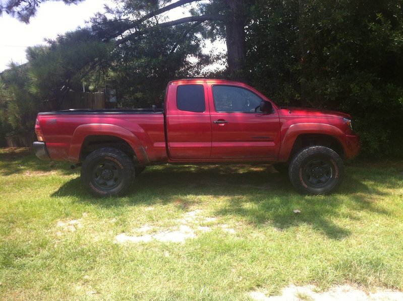

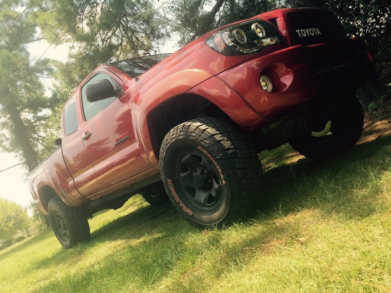

    Yes it can be done. That's basically my old setup. This is with just maxtrac's and 1.25" spacers in the front and all pro standards in the rear

    I want those tires. How do you like them?
    What size were they in this pic?
    Thanks man​

    I love them. They are as loud as any M/T but the look amazing so I'm fine with it. They are 285/75/r16's. I think I am going to get another set in 35x12.50r17.

    How did you like the ap leafs? Did you add any extra to the pack to make it sit level?

    I like them. They flex pretty well, I have 11" travel shocks and they are the limiting factor of the rear. They are a little stiff on the access cab and so they sit a little high. I got ~4" of lift out of them.
