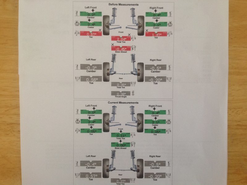

    94.5 F350, 77 F150, 74 F100, 11 Jeep Grand Cherokee
    Lift, wheels, tires
    I bought them with about half tread and put 10k on them. The tire pictured is worn from misalignment but the ones from the rear still have 1/4 tread. Basically I would expect 40k+ If rotated regularly.

    Tracking straight again,

    Nice!!! Thats a good feeling :thumbsup:
