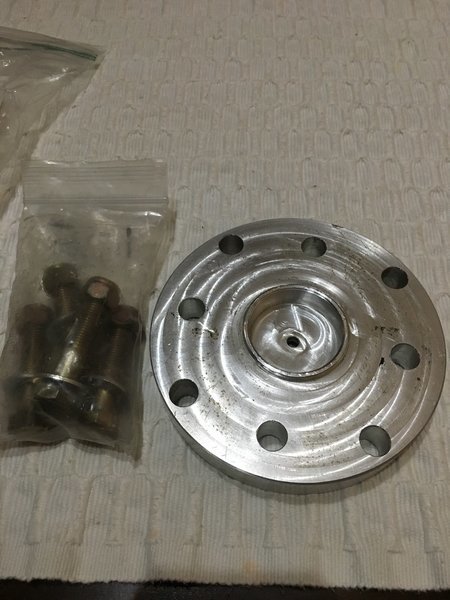

    I'm at work so I can't see if you posted a pic of it but PreRunners only have juan spacer available to us, our bolt pattern is different and it took me ordering the wrong one twice to find this out. www.4crawler.com is the only manufacturer of the size I needed, and it's probably your destiny as well. Word on the street is different years may even have different flange sizes so I recommend getting under there with your favorite metric ruler & a pad of paper.

    Yes, you need to do it that way because you may or may not need it. And if you do, you need to know what thickness. Lift, then measure, if it is out more than 3/8" then order what you need to push it back in. Between in or out 1/4" is how you want it to look.

    From www.4crawler.com
    order the 65mmx65mm the holes are actually slotted and will accommodate 10mm or 11mm bolts.

    I've still got it man. Let me know if anyone needs it. It's a 3/4" 66x66mm from 4crawler. That's the size my 2012 takes but 4crawlers website explains how to measure to make sure yours take the same.

  19. Feb 24, 2017 at 4:30 AM
    HuntTaco
    HuntTaco Well-Known Member
    Jun 29, 2016
    #190814
    156
    Derek
    Chesapeake, VA
    2013 MGM Prerunner
    Maxtrac 4" kit Bilstein 5100's Mastercraft 305/70/16
  20. Feb 24, 2017 at 4:31 AM
    ChadsPride
    Nov 26, 2014
    #143119
    127,312
    Sponsored by TacomaWorld.com
    :ohsnap:
    Thats some fine looking meat sir!!!
