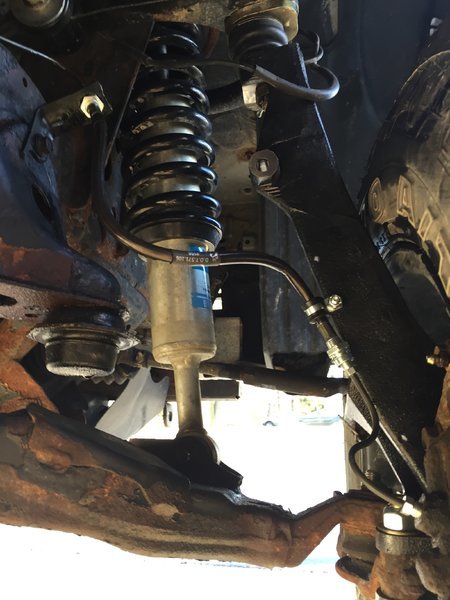

    Ok gents kinda confused here?
    06 pre dblcsb (empty bed)
    Dakars with 5160's measuring 25.5" hub to fender. (Perfect)
    Maxtrac 4" with 6112's buttom notch measuring 27.5" yep 27.5" (WTF)!
    Has not been aligned yet so the thing I can think of is caster was at 3.4?
    Any thoughts???

    what is your spring rate?

    No idea? Whatever comes on the 6112's?

    do you have a pic of your set up?

    I can take some... anything in particular?

    your front coilover either side doesn't matter which. but the whole suspension in the pic

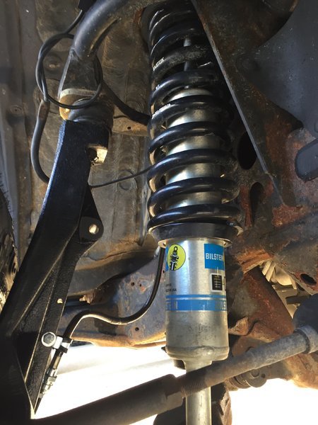

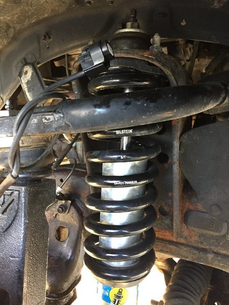

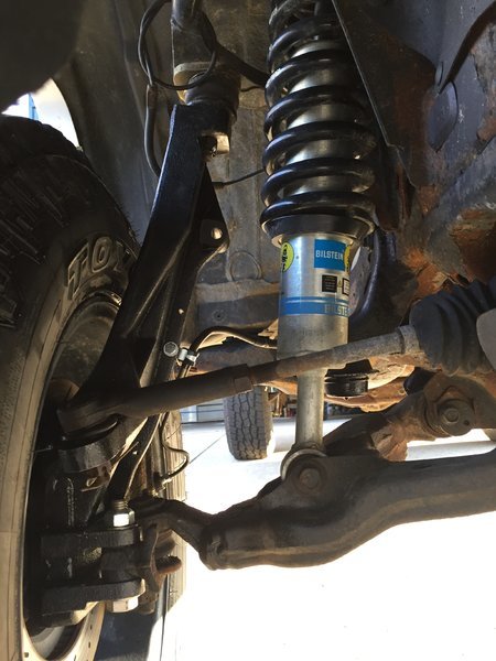

    everything looks good. did you tighten up your control arms while the truck was on the ground and not at full drop?

    your also going to want to get that abs sensor plugged in

    At droop but I pulled them down to the spindle

    you should have tightened them at full load. loosen and tighten them while the truck is on the ground and recheck measurement

    At the ball joint or frame?

    at the frame mount.
