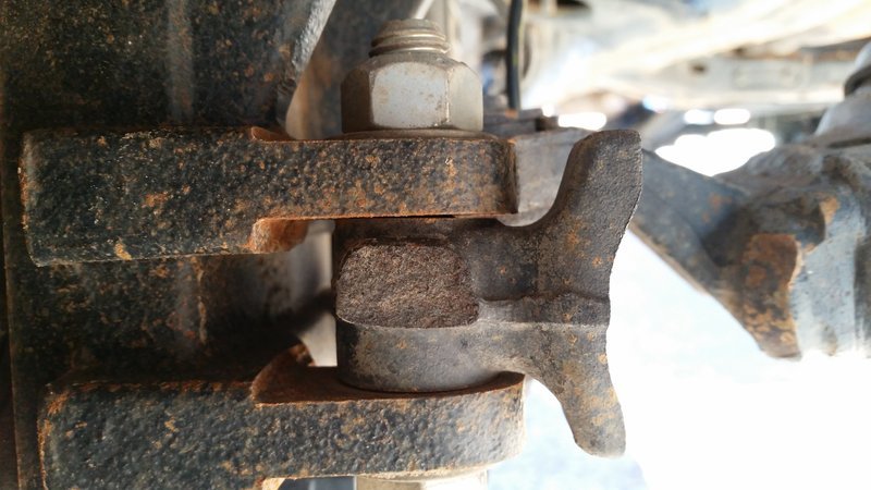

    I have a similar issue but not the same. The hole that the bolt goes through it's bigger then the bolt and there is some play. Definitely notice it when breaking

    I'm not sure I can torque the nut enough to bend the cast iron maxtrac but I can try

    Did you buy your spindles new? If so, how long ago? Seems odd you would have space.

    Yea I bought them new and back in last December, as in 3 months ago december..
    I called maxtrac and the guy told me to retorque it. I just don't see how that would bend 3/4 solid iron
