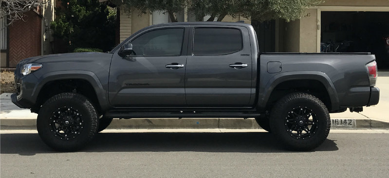

  15. Feb 27, 2017 at 8:22 AM
    TacoMaxxxx
    TacoMaxxxx Well-Known Member
    Feb 12, 2017
    #210433
    102
    Orange County, CA
    2016 Limited
    I am running 4" in the front (MaxTrac) and 2" in the back (Deaver U402's) and I sit completely level at 24/24. I barely clear 285/70R17's with Icon UCA's. Tacoma .jpg
  16. Feb 27, 2017 at 8:29 AM
    dumontrider
    dumontrider Well-Known Member
    Jan 26, 2012
    #71464
    3,050
    Jason
    La Habra, CA
    14 GX460
    That is the definition of level, look at the curb under your frame, dead even gap front to rear, bravo.
