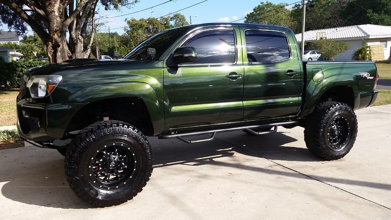

    No need for custom leaf packs for 4", instead of All Pro standards or Dakars for 3" he could get All Pro expos & get 4".
    I have them with 2" blocks for 6" & measure 27.75" in the rear hub to fender. My front measures 27.5" with Maxtracs & OME 885's on 5100's set at 0 for 7"

    Need to know what the 3 leaf aal will provide.

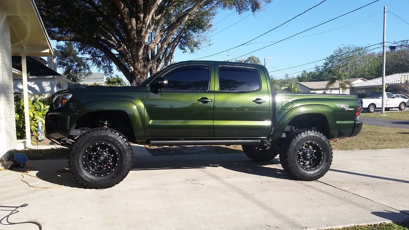

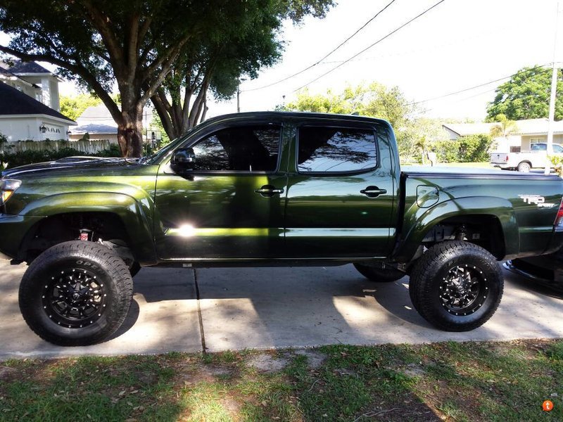

    This is my truck when it hat the same setup in front, spindles with 5100's @ 1.75 & Toytec 1/4" spacers for 6.25. In the rear I had my All Pro expos & 1.5" blocks for 5.5". Keep in mind I have 35's.
    My truck with spindles & billies @ 1.75, nothing else for 5.75. Rear the same, All Pro expos & 1.5" blocks. This is when I had 285's, basically a 33".

    The first pic is 7" up front & 6" in the rear with 35's.
    Second pic is 5.75 up front & 5.5" in the rear with 285's.
    That 1.5" is all you'll get, 1.5 more than you have now. So you'll be bro leaning pretty bad. Haha
    With 6.25 you'll be about like the 2nd & 3rd pics, actually a little more clearance.
