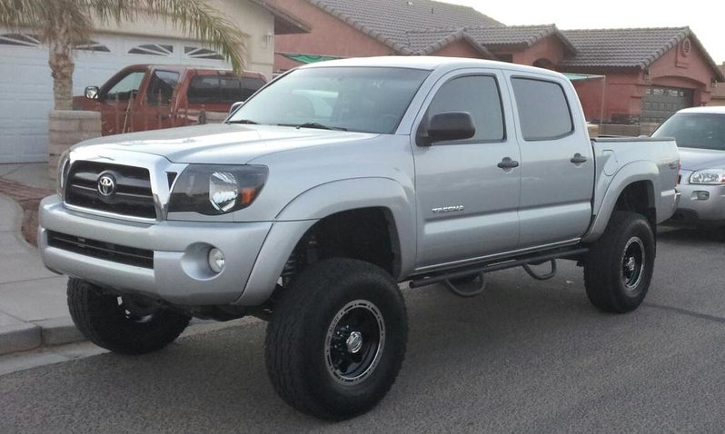

    markmatters
    markmatters [OP] Viejon
    Nov 4, 2011
    #66436
    1,311
    Mark
    Yuma, AZ
    2007 PreRunner
    Edit: stupid phone
  19. May 17, 2012 at 8:40 PM
    #1039
    markmatters
    Nov 4, 2011
    #66436
    1,311
    Mark
    Yuma, AZ
    2007 PreRunner
    Didnt know where to post this...new wheels and MAXTRAC SPINDLES....i guess. Hah.
