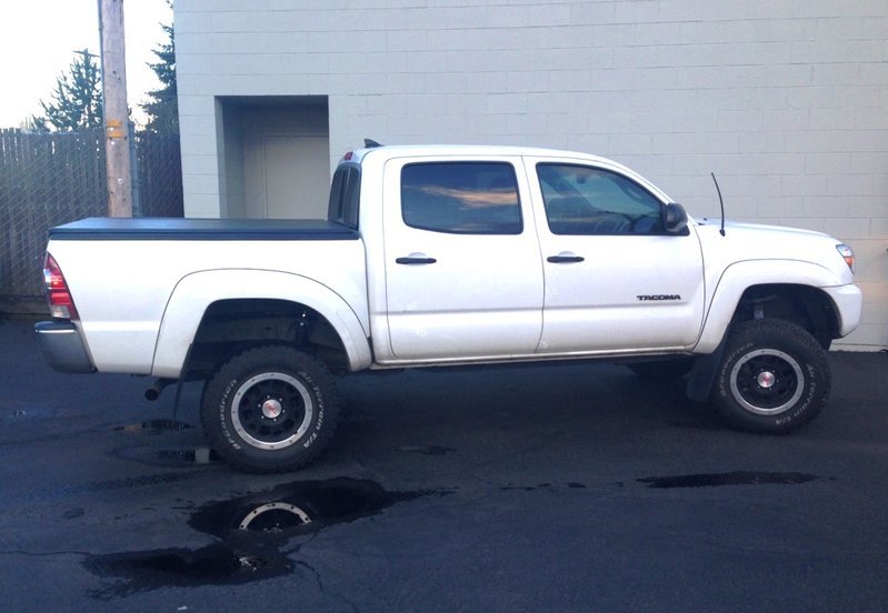

    I'm like many of you. Try to lay out a plan and have all the parts (maybe more) on hand and available, attempting to make one session of installation. I plan Dakars, but, trying to move forward, temporarily was installing AAL and blocks. I've used blocks in the past, they don't offend me.
    Once the AAL and blocks where installed ~ to tall at the rear. So the shop removed the AAL's. Now I'm blocks only (3") on stock rear leafs. I have the classic axle wrap, clunk when stopping, at the point I release the brakes to move forward. So, SAVE for spring packs..! The blocks, as all expect makes the wrap worse.
    It looks good, is drive-able. But I'm sure new leaf packs will have been the best option for me in the long run...
    I'll be moving up to 285's and leaf packs. Currently 265's / TRD 16" wheels no spacers front or rear, yet.
