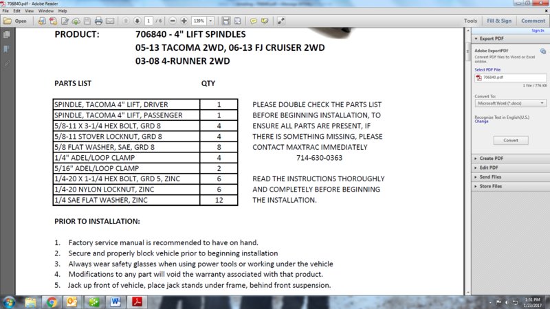

    Maxtrac includes hardware as well? I assumed they used existing hardware to bolt on. I got mine used so it wasn't included. I'm mainly concerned with my strut assembly hardware that connects to the coil bucket. My truck has 192,000 on it now but I'm not sure the age of the hardware or if it was original when the truck came to me. :sadviolin:

    Just hardware for the spindles

    Check post 9586 for the parts list, no go on a turn-key package of hardware
