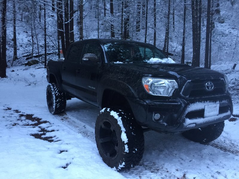

    Lifted 2013 prerunner doublecab v6
    6.5 maxtrac / 20x12 rockstar 2's and 35" toyos.

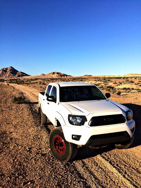

    PreRunner
    Method double standard 16's fit like a glove
