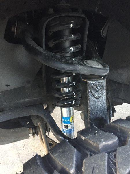

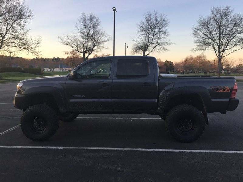

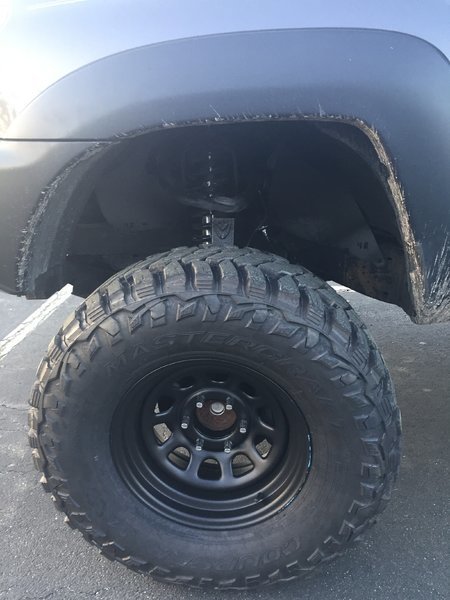

    Ended up having to run spacers (inch and a quarter) to get the wheels to fit and not rub the caliper. That is the only rubbing that was occurring. No need for a CMC, only had to remove a little bit of the plastic by the air dam. Might have to come down one notch on the clip...got my alignment Saturday morning and all numbers are in the green but the tech advised that the height is stressing the UCA's a bit.
    removed the front mud flaps to avoid rubbing but kept the rear so i don't sling anything into a persons windshield behind me. The bilsteins are amazing, the rear absorbs bumps like a champ and the fronts don't drop the nose of the vehicle when breaking.
    The block (3") and the 3-leaf AAL have made the rear perfectly level with the front. Almost didn't need the extended rear break lines but had the shop throw them in just to be safe. Barely any vibrations and the tires are certainly not as loud as i expected.
    Family friend that has a shop lift and all the tools fell through so i had to scramble and find a shop locally (Pungo Off-Road) that would install the kit. I would have loved to get my hands dirty and do this myself but looking at it, i def do not think it would have come out as good so HUGE shout out to Pungo Off-Road for their efforts and professionalism and turning this around on the same day i brought her in. I couldn't be happier.
    Also a HUGE thank you goes out to @White Horse @SpruceTaco @ChadsPride (amongst others that i am forgetting, my apologies) for all of their help and friendly advice and inspiration.

    Hub to fender measurements. your truck looks great man :thumbsup:
