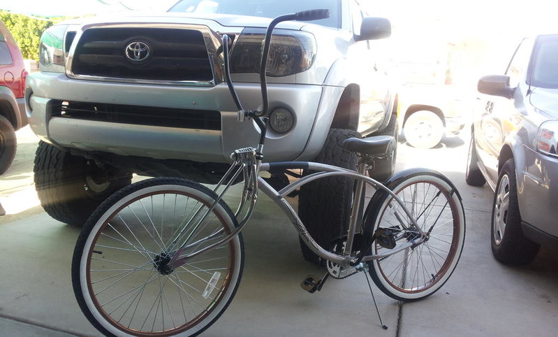

    Lol youre lucky i was relaxing and having a beer in front of my truck...
    Front driver and passenger: 27 3/4"
    Rear: 26 3/4"
