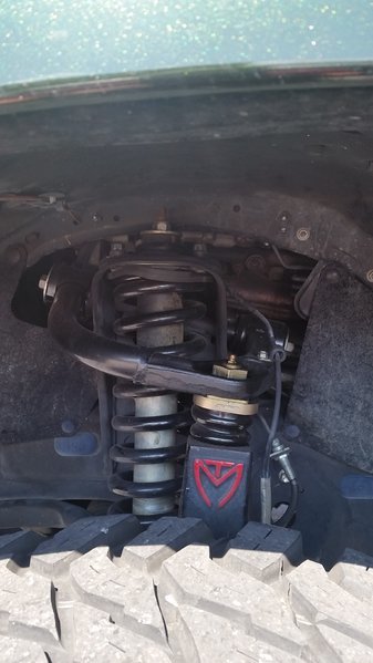

    Does anyone know if you can run spc UCA with with the spindles and stock springs and shock's. I just changed my set up and it doesn't look right

    Spindle has no effect on UCA or shocks, what looks off?

    It just looks like the UCA sits up way to high. making it where it limits tha travel. I don't know if it just me or that's the way it is suppose to look

    I have SPC uca with the spindles but I'm running 5100's with 885's also. So that's an additional 3" of lift.

    From memory & Google, UCA normally sits about level, maybe a few degrees down but not much unless you've changed your shock. The only other things that could cause the UCA to be higher would be a load on that corner suspension, or the ball joint isn't all the way thru the UCA. Pull up the boot & make sure the ball joint shaft is all the way down. Also, was this pic after driving a little bit to let it settle?

    The UCA look like they sit up way to high

    No they're angled down some.

    I think they look a little high but have really looked at one with just spindles. Every one I've done has been spindles plus something else. How do the look compared to yours? Yours is pretty close to his setup even though you have stock uca's.

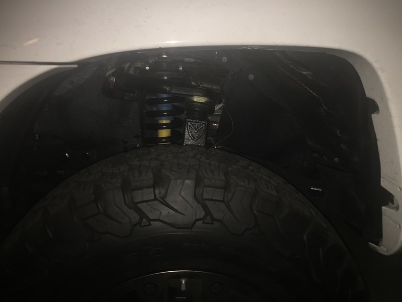

    Here's mine, but I've got 1inch lift added to the Maxtracs
    So my UCA is just slightly dropped
