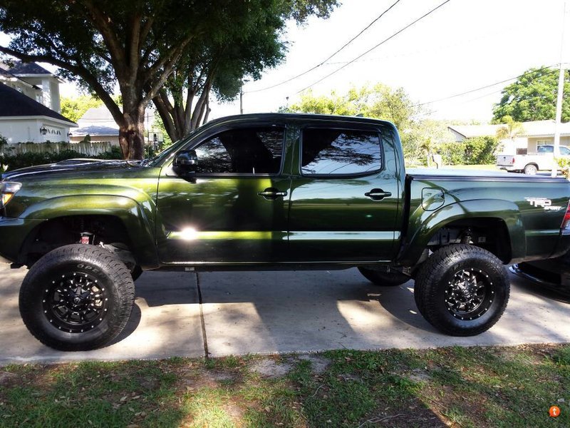

    It wouldn't look terrible but 285's will be borderline small lookin.
    This is when I was at 5.75 with 285's
