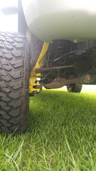

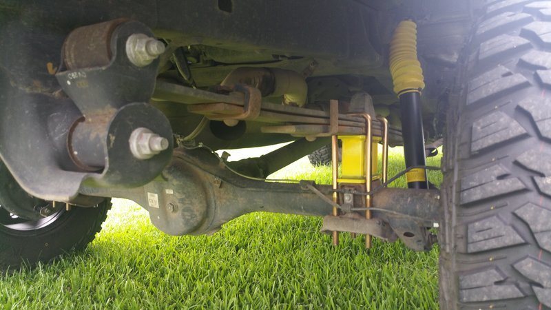

    Got the 6/4 maxtrac kit
    2 inch spacers, 16x10 ion alloys, 285 Kanata mud hawgs
    Took about four hours total to install due to issues unrelated to the lift..siezed cam tabs and bushings and a brake line crossthreaded and wouldn't let the hose go.
    Over all it was a pretty straight forward install and everything's good so far.
    txtaco87 and ChadsPride like this.

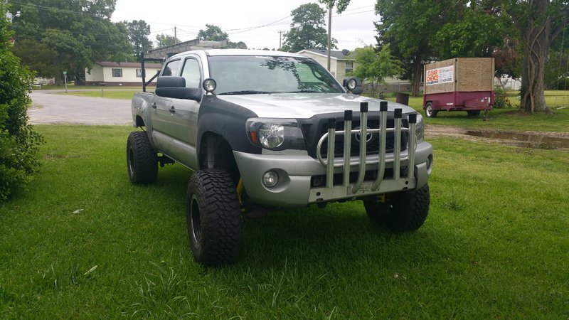

    Your truck is awesome man!!! 4hrs!! Were some friends able to help?
    I really like the fishing rod holder on the front. Did you make that?
  11. May 15, 2017 at 2:45 PM
    bottomfeeder777
    bottomfeeder777 Well-Known Member
    Nov 26, 2015
    #170747
    56
    Lincoln
    Outer Banks, NC
    08 Single cab 5 lug
    3/2 inch lift, snorkel, 9k winch, stereo, only the finest air fresheners AutoZone has to offer
    Thanks man. This things my pride and joy haha.
    Yea I had a buddy help me out. He did one side and I did the other. The siezed busing took the longest to mess with.
    And no the rod holder was a gift

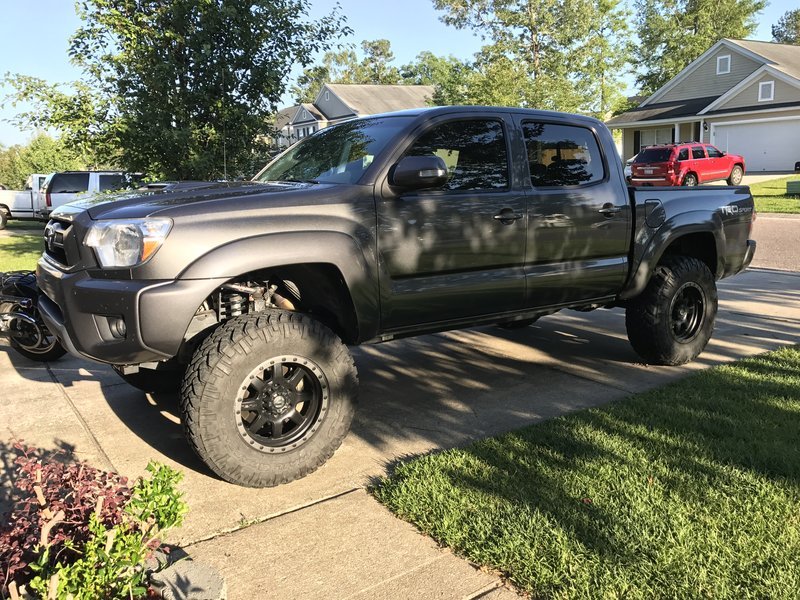

    2017 DCSB TRD OFF-ROAD OV TUUUUNED
    Just curious does anyone still rub with MaxTrac's up front? I'm rubbing in reverse only on the front plastic inner fender. Thinking about either taking it out or putting some heat to it and bending it back a little.
    ChadsPride likes this.
  18. May 15, 2017 at 4:44 PM
    ChadsPride
    Nov 26, 2014
    #143119
    127,312
    Sponsored by TacomaWorld.com
    Did you trim it at all?
    What size tires?
    Wheel specs?
  19. May 15, 2017 at 4:59 PM
    Arpatton86
    Arpatton86 Well-Known Member
    Nov 9, 2014
    #142003
    233
    Ontario Canadia
    I haven't trimmed the front fender yet. Tires are 285/70/17r, fuel trophies with 4.5" back spacing I believe. I should also note that I haven't had the truck aligned yet, if that will make any difference.
