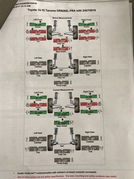

    I'm not a huge fan of driving with an alignment it feels a little squirelly I didn't want to wait for 5 hours at firestone to have it done today though. I'll take some pictures tomorrow where I'm getting some rubbing.

    I actually got everything buttoned up on Sunday afternoon. I had an issue with my camburg UCA's, so it took me a little longer than planned other than that Pretty straight forward install. Next I'm going to be replacing the rack and pinion bushings not looking forward to that at all.

    Got her all aligned up, well as close as they could. That lifetime alignment sure pays for itself after awhile. Only issue they had was the left camber tab was bent (which I knew about), drives better now but I'm still getting some steering feedback. I'm almost positive it's my rack bushings.

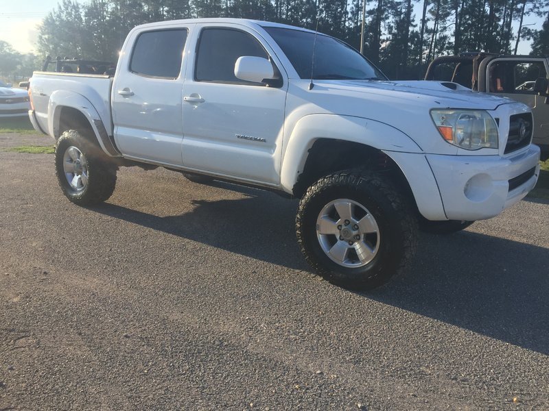

    4x4
