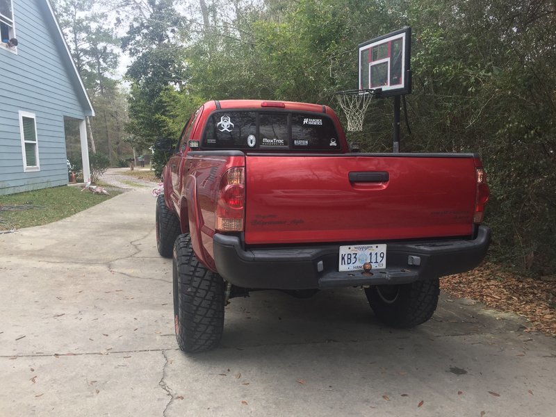

  19. Jun 17, 2017 at 7:14 AM
    Taco Nation
    Taco Nation Well-Known Member
    Jul 21, 2014
    #134354
    1,867
    Zack
    Clinton, MS
    94.5 F350, 77 F150, 74 F100, 11 Jeep Grand Cherokee
    Lift, wheels, tires
    Sorry these are all that I have but here's what 1.25" in the front and 2" in the rear looked like. The rear is actually a tad wider due to the lift. Hard for me to explain but the control arms pull the hub inward as you increase lift due to the circular path the hub travels on. I'm doing a terrible job explaining but anyways.IMG_3255.jpg DSC_0956.jpg
