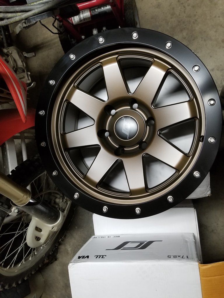

    So this just happened today. If only I didn't have to wait for tires20170630_205219.jpg 20170630_205046.jpg

    :drool::drool::drool::drool::drool:

    If you'd like to just send those my way. That would be pretty cool. Just saying :jellydance:

    No no no, they need to be sent my way. I think they'd look better with my green. :D

    But I have stocks :pout:
