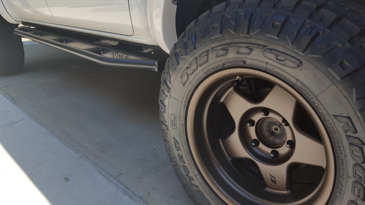

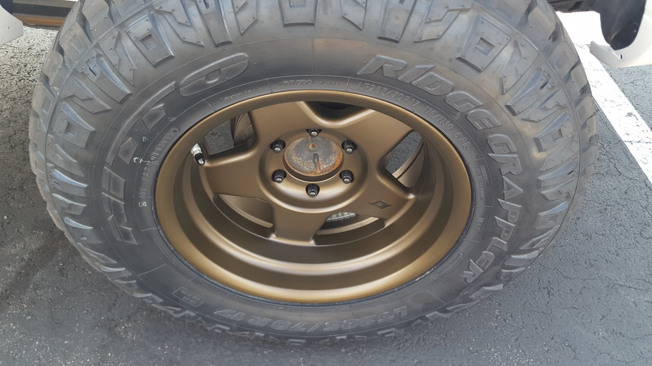

    Re: My question on my wheels, I have attached an image - I believe they're 16x7's. I would prefer to keep them unless it's wiser to go aftermarket for some reason. I don't know much about backspacing so I was unsure if they would be conducive for what I am trying to do.

    2. If I plan on going the route of Maxtracs (4") - can I use my stock wheels? I'm kind of a minimalist and actually like the stock look. If not, what should I look into? Backspacing? Huh?
    Wheel requirements are 17" wheels with a max backspace of 4.75. That being said some have run 16" with a shallow backspace. You can run stock wheels but will need wheel spacers to clear.

    I'll look into wheels I suppose. Whats ideal as far as backspacing goes?
    Also, thanks for the picture - that's really helpful!

    You're welcome. I'm running 17x9 with 4.5" backspace & I've had no issues. I can post some pics of them with 285's & 35's on them if you'd like.

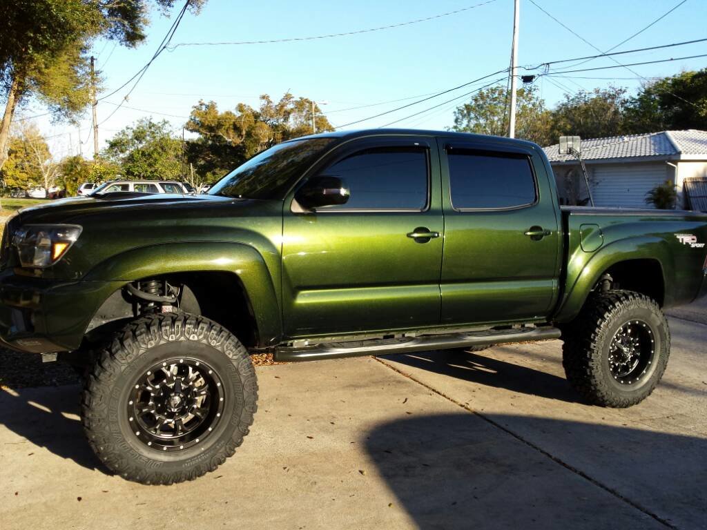

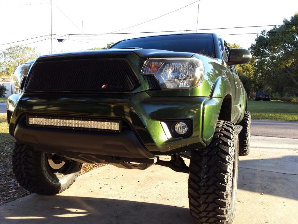

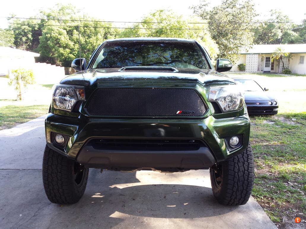

    Here ya go.
    With 285's & spindles but I'm lifted 6", I don't really have any showing how much they stick out.
    With 35x12.5
