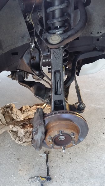

    factory coils / bottom shock setting pictured here?

    I can't remember to be honest but I want to say yes. That's @fast_evan on IG.
