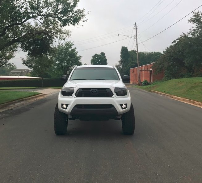

    All done! Just need another inch or two in the rear.... (that's what she said).
    @ajohnson, you're the man. Couldn't have done it without ya.
    Thanks to you too @SpruceTaco for answering so many on the fly texts. :thumbsup:

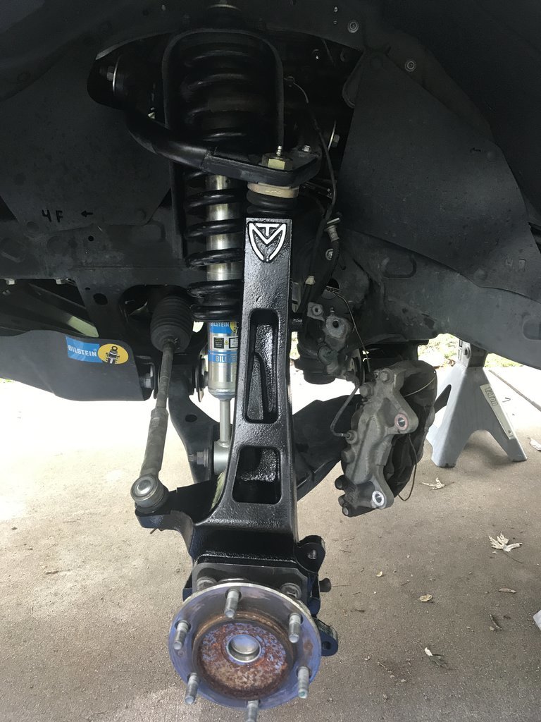

    Alignment scheduled for tomorrow morning. Looks like i'll have to trim a tad more of the fender plastic, and possible the front fender liner? Did any of you zip tie the front inner fender liner (black) out of the way?
  9. Aug 14, 2017 at 9:00 AM
    ChadsPride
    Nov 26, 2014
    #143119
    127,312
    Sponsored by TacomaWorld.com
    I just trimmed some it away
  10. Aug 14, 2017 at 9:01 AM
    ensaladas
    ensaladas DarthT8er
    Jul 13, 2015
    #159346
    1,629
    ‘23 Trail Edition
    yep, can always do that. I just remember someone saying there was a clean and hidden way to zip tie it up out of the way.

    Yep I trimmed mine but the problem is I had to trim where it mounts to the outer fender, so it was just flopping around when I got up to speed. I used black zip ties & secured it up about 4" out of the way.

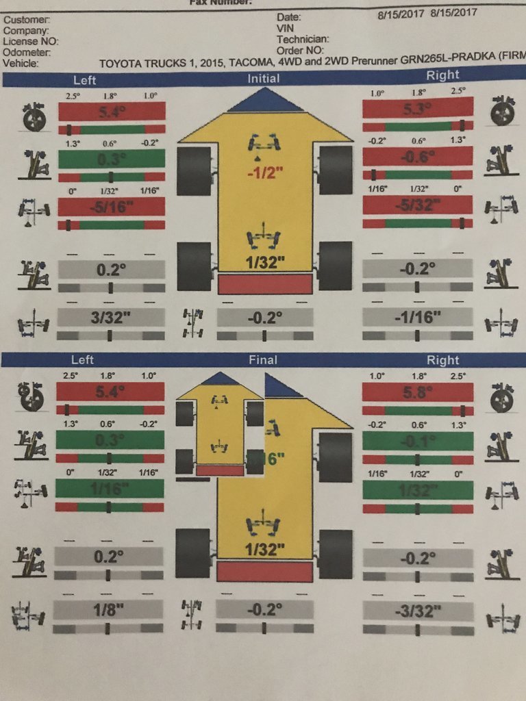

    Alignment dialed in.

    He went with almost 5+ degrees of caster (0 camber/toe), which i was intially concerned about. But I guess its fine, as the wheels are directly in the middle of wheel well, do not hit cab mount, and only bareeeely touch inner black plastic in the front of fender when turning/braking at same time

    Looks great, I have 4° of caster.

    So I misspoke, it's at almost 6 degrees of caster. That's the most I've seen... it drives awesome and doesn't rub, I think this why he went that high, to prevent me from rubbing, which I anticipated.
