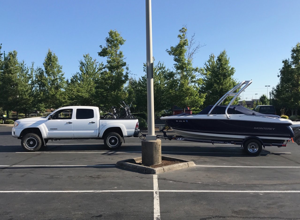

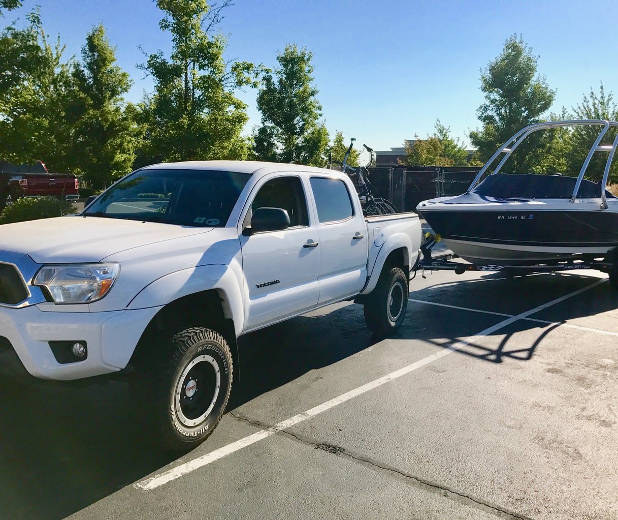

    I started with blocks and add-a-leaf's, then, within a month changed to Dakar's = perfection. I tow a single axle trailer / boat, it works great ~ just took a trip, nine hours each direction, couldn't ask for better. Really worth the expense and peace of mind, especially with a load and / or towing.July 1.jpg July 2.jpg

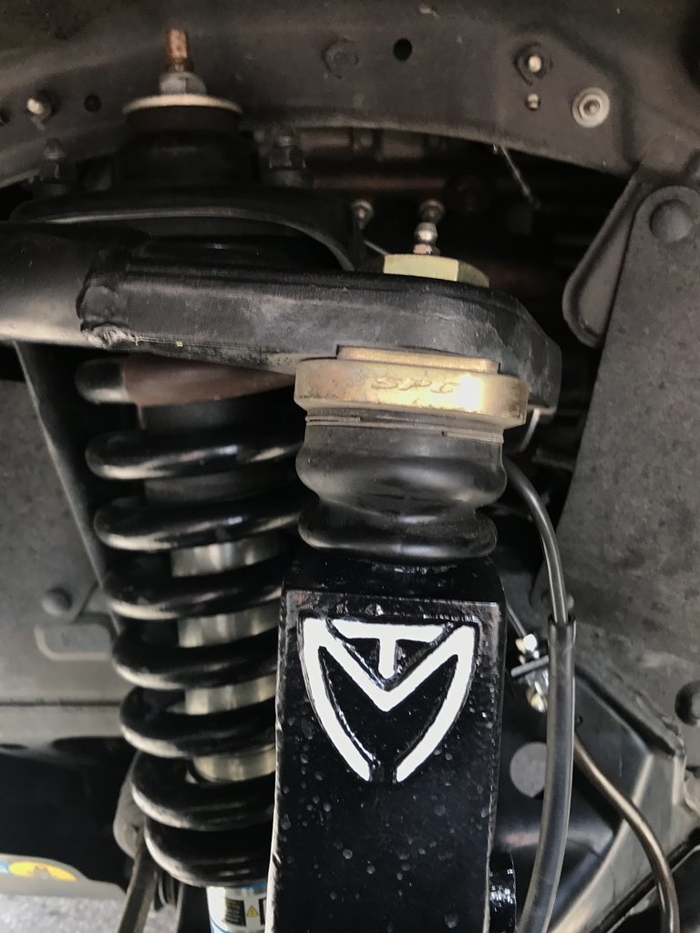

    Does the uca angle look off to anyone? 5100s bottom setting, factory coils, Lr UCAs. I'm probably over thinking it, since I'm used to looking at it with the 887s where there was some droop. We're the factory UCAs almost horizontal?

    I've got a little drop in my OEM UCA from the 3rd gen TRD OR shocks and coils
    You might need a taller coil :p

    Thanks, I guess I'm over thinking it as usual. Anyone else running lr UCAs on factory coils?

    The LR UCA ball joint is much longer than stock BJ so that why it's probably a little more horizontal

    Makes sense. Not having issues or anything, it just caught my eye and looked funny to me today after I parked.

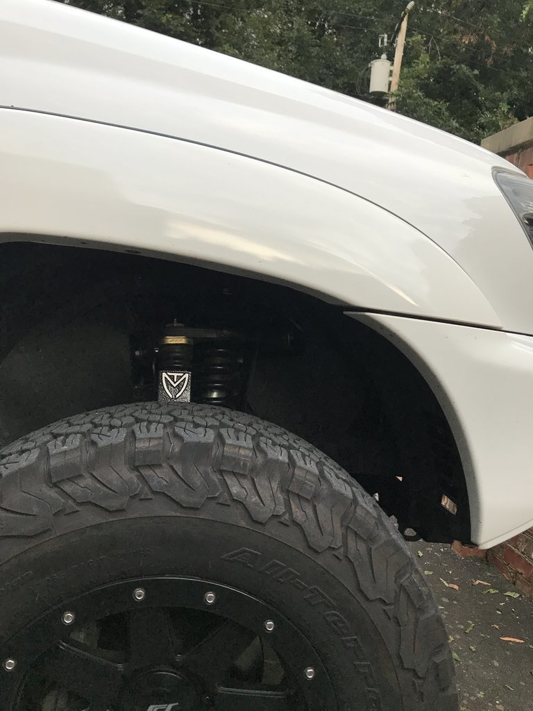

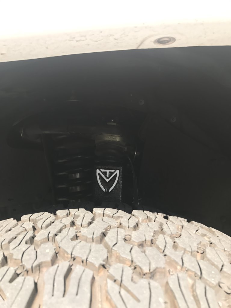

    Pic of my kit for attention :)
