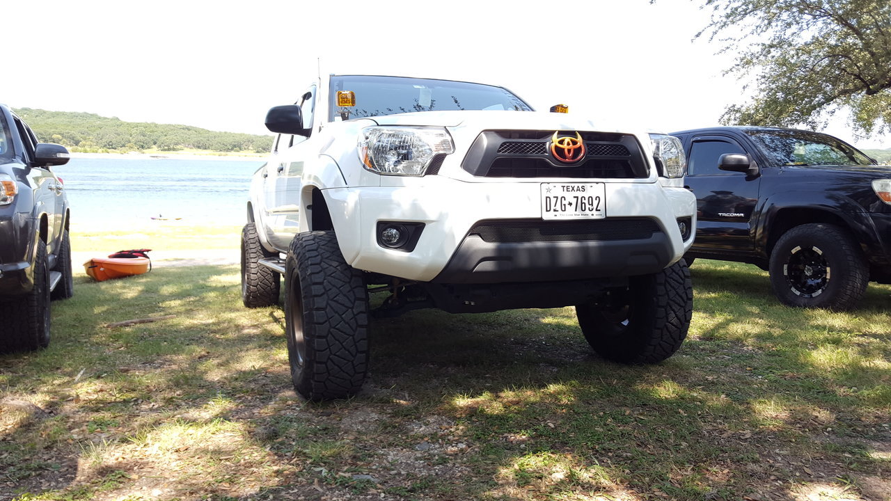

    Hey no problem bud.
    I spent a lot of time deciding before I got my kit.
    SO MANY OPTIONS!!!
    What's great about this kit...is you can add fancy coilovers down the line at any time.
    I plan to get a full ADS setup whenever the truck and wife's Toyotas are paid off.
    More pics for attention lol
    rainyben45[QUOTED] likes this.

    Sometimes I wish my devil horns actually stayed that color and vibrant...
    rainyben45 likes this.

    She's got covered parking at home and at work
    BassAckwards and i30nes[QUOTED] like this.

    Haha! True... Once mine faded out they had to get painted.
