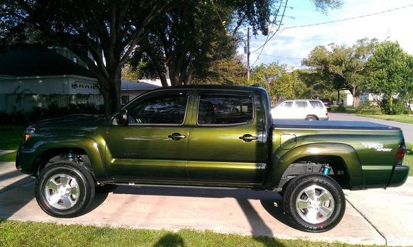

    Not a short bed but this is one we did the 4" kit on. It has 2" blocks it the rear & just spindles in the front with 285's. He also kept all the stock suspension.

    Looks great. Judging by the tires I’d HAVE to upgrade my 265s to some 285s either before or right after the lift to keep the truck from looking like she skipped leg day. That’s the same setup I’m looking to do if I don’t go suspension lift.

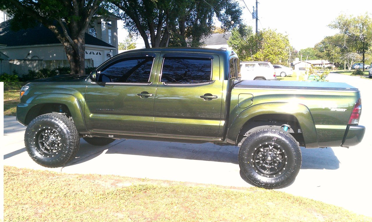

    I rode around with a 3" lift & 265'a for a while. Didn't have money for tires. Lol

    Doesn’t look too bad! Are those 17” wheels? Mine are 16”....definitely want to get up to 285s eventually but yeah....it might take me a while to save up

    Yeah 17" sport wheels.
    After new wheels & 285's, still with the same cheap 3" spacer lift in front but that is what the rear would look like with 2" blocks & 285's. About 4 yrs ago, so much has changed. Haha
