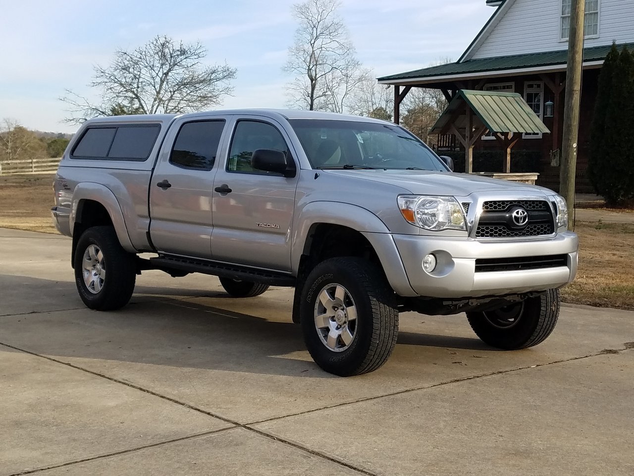

  10. Feb 3, 2018 at 7:56 PM
    butchjr66
    butchjr66 Butchjr66
    Jan 30, 2018
    #242887
    13
    Aragon , Georgia
    2011 double cab long bed prerunner
    4 inch spindles front bastard pack leafs in rear
    ChadsPride likes this.
  11. Feb 3, 2018 at 7:58 PM
    butchjr66
    butchjr66 Butchjr66
    Jan 30, 2018
    #242887
    13
    Aragon , Georgia
    17 inch FJ wheels with 4-7/8" backspce 285/70/17 Michelin , no problems !

    Looks good!!!! What are you running out back?
  13. Feb 4, 2018 at 6:20 AM
    butchjr66
    butchjr66 Butchjr66
    Jan 30, 2018
    #242887
    13
    Aragon , Georgia
    I used the stock top leaf from Tacoma and added 4 leafs from 1987 Chevy 4x4 half ton rears and then turned the Tacoma overload leaf upside down . Takes a pretty heavy load and still rides smooth

    No , just joined a couple days ago and still learning my way round here lol ! I have noticed that my truck is lower on the driver side now and see some people adding a 1/4" spacer to correct this , mine looks to be almost a full inch , not sure that would do the fix ?
    ChadsPride[QUOTED] likes this.

    1/4" plate above the coil over, and 1/2" plate under the leaf pack. @ToyTec Lifts sells both.

    So adding the 1/4" above front strut and then 1/2" under rear leaf , both front and rear on drivers side would correct this . Thanks , had no idea this was a common Tacoma issue with lifts !

    Should correct, no guarantees that it will be even on both sides. Lean is an issue due to added weight on the drivers side. You have the gas tank, battery, brake master cylinder, and driver all weighing the truck down over there.
