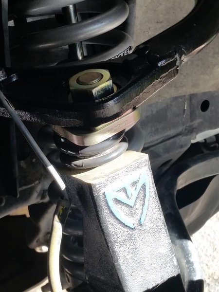

  3. Mar 22, 2018 at 4:29 AM
    ChadsPride
