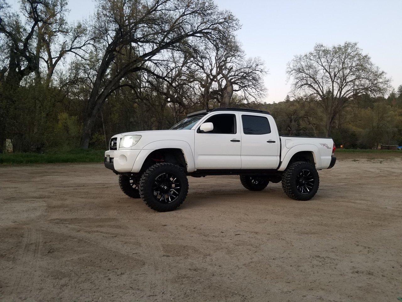

    What's your set up in the rear?

    2in aal and 3 inch block for the time being, with bilstein b110 shocks. The lean isn't as bad as the picture makes it look

    Mucho Nice!!!! Did you go with aftermarket uppers?

    Thanks! And Yeah I went with the jba uppers
