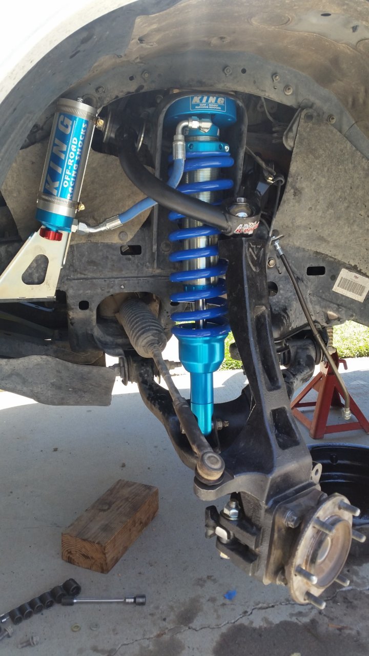

    Working on it now....UNDER CONSTRUCTION
    Thanks! 4 inch in front 2.5 in the rear.
