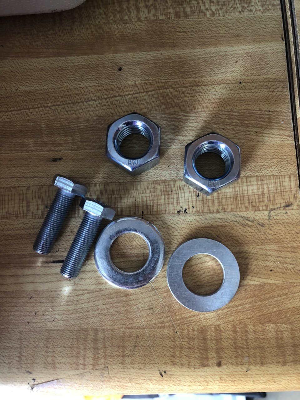

    Installed everything but the rear and am loving it so far!! I ran into a pretty major snag when doing the spindles though, so be aware. I had two of the four 5/8” nuts that were clearly the wrong thread pitch for the supplied 5/8 bolts. A quick stop at Lowe’s solved my issues.Those brake lines were no joke either! I also had to break out Señor Dremel and go to town in my wheel wells. I’m running 295/75r16s. I’ll eventually do the pinch weld and CMC if I notice any rubbing. Took her out for an hour drive through some back roads and she drives and handles perfect! Anyhow. Here are a few pictures of my girl so far. Before and after!

    Truck looks good!!! I didn't like the feel of a couple nuts and bolts that were supplied by MT so I replaced it all with new hardware during install.
    Thor170[QUOTED] likes this.

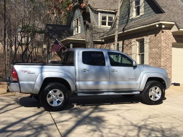

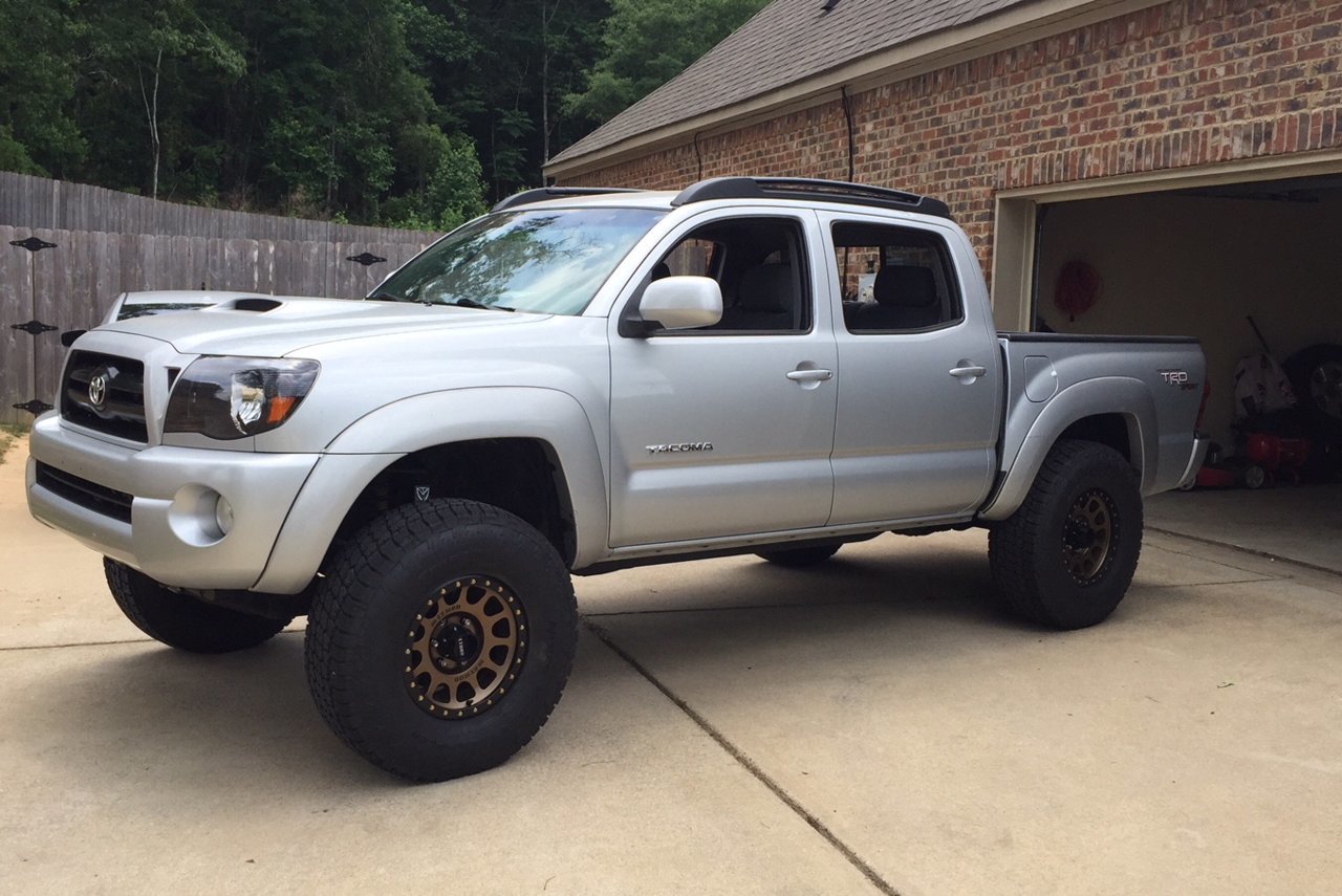

    Alright gents,
    Trying to solicit some expertise from you all. I've got an '06 TRD Sport (pictured) and I just installed my 4" Maxtracs and Biletein 5100s (set to 0) this past weekend and wrapped my Method NVs with 295/75-16s. After re-checking my work 5 times, bleeding the brakes and cutting inside my wheel wells, she's a dream to drive and feels like a pillow and doesn't pull to either side (note: I haven't raised the rear yet. Will be working it this weekend when I get time).
    My concern is this...when driving anywhere over, say 65mph, the front end barely feels like it's connecting with the pavement. She feels like she wants to lift and get air-born. Is this because the front end needs to be aligned or is it because the stance is still in bro-mode? I kinda like the stance to be honest. I'd consider keeping it this way, but the smallest load I carry will have me looking like I'm smuggling immigrants. I appreciate any and all advice/wisdom/buffoonery you all can provide.
    Biscuits and ChadsPride like this.
  6. May 22, 2018 at 1:34 PM
    ChadsPride
    Nov 26, 2014
    #143119
    127,312
    Sponsored by TacomaWorld.com
    Whoa!! Truck looks awesome!!!
    You'll definitely want to get an alignment as soon as possible.
    It'll take you a bit to get used to it, especially since you have such a dramatic change.
    What kind of lift parts do you have for the rear?
    My truck tracks better with the Maxtrac spindles. Feels weird to say but I think it's true.

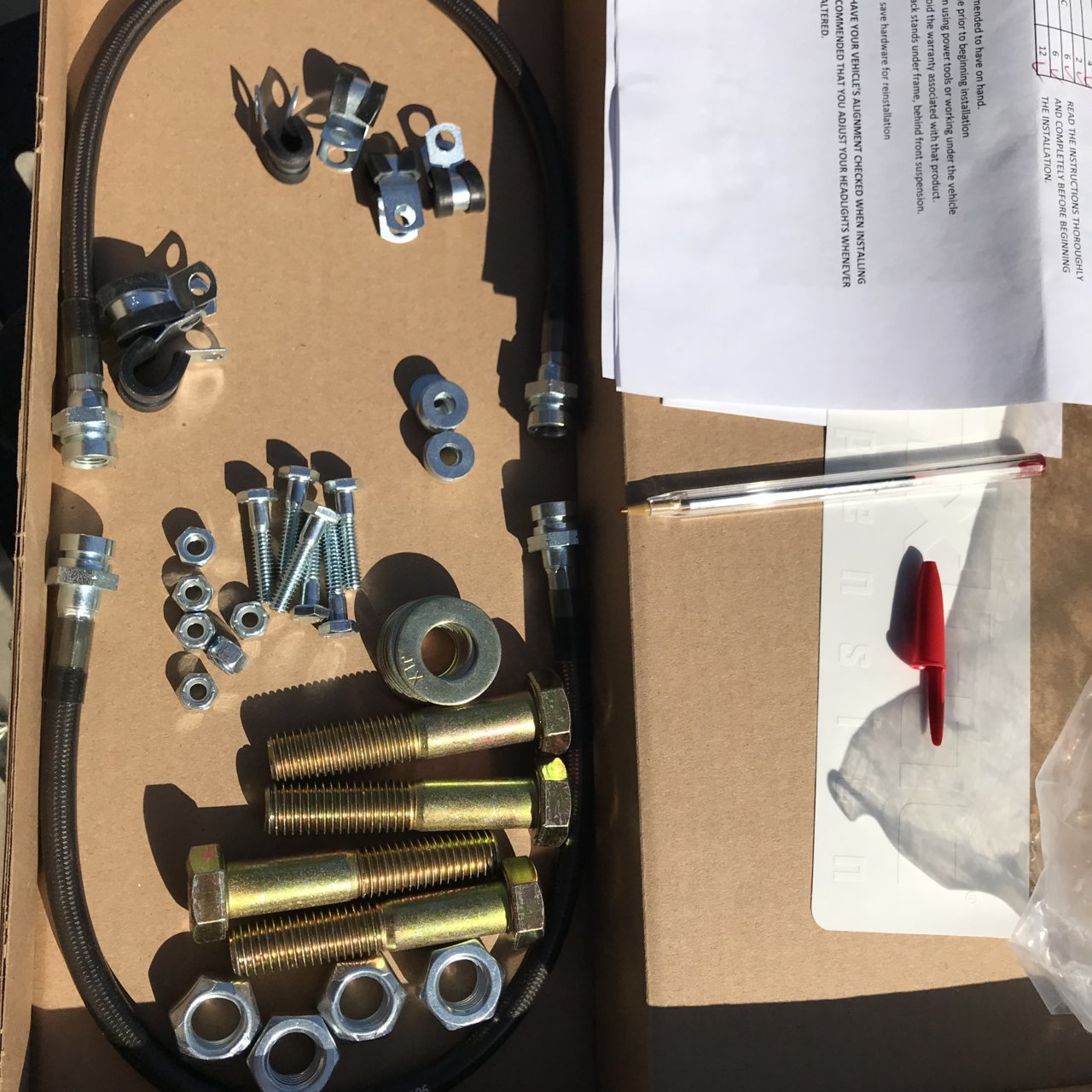

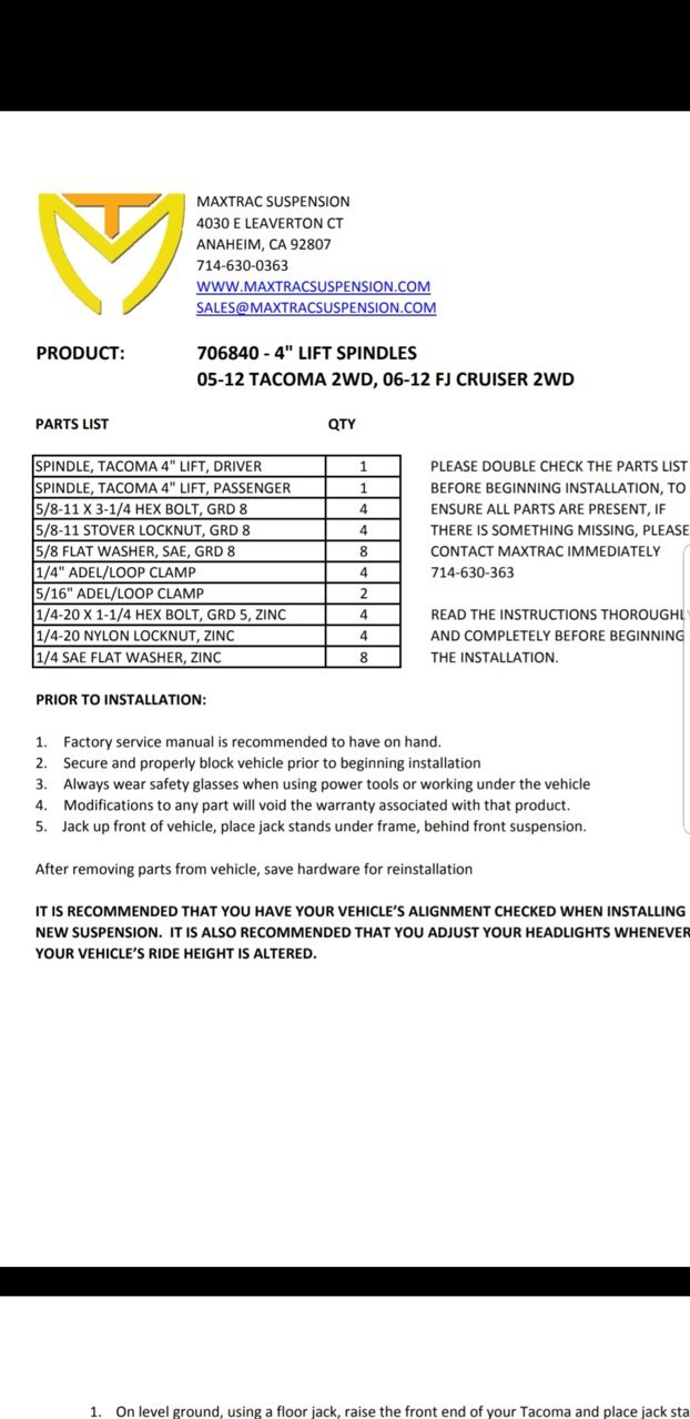

    So, sort of understand that breakdown, found out previous owner of the maxtracs left me some hardware lol
    Is this all I need?
    ChadsPride[QUOTED] likes this.
  16. May 31, 2018 at 6:39 PM
    desertrunner24
    desertrunner24 Well-Known Member
    Oct 30, 2016
    #201101
    3,954
    Jake
    Fresno , CA
    2011 TRD offroad 4x4
    Some
    Lol your missing a few parts. You need 4 grade 8 bolts 5/8x11 3-1/4" with lock nuts and washers to bolt the lower ball joint on. The other stuff is for bolting the wire and lines to the spindle. I'm not sure what those bolts pictured are for but they're not for the maxtracs
    PapaBear[QUOTED] and ChadsPride like this.
