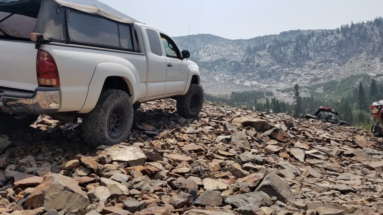

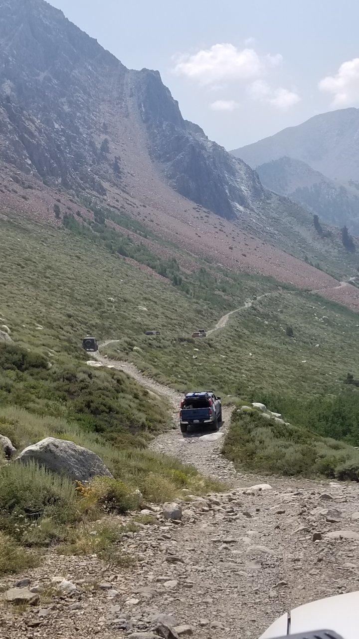

    Maxtrac spindles FTW! Out of 15 rigs, 3 of us were 2wd. 2 of us 2wd were locked (other guy had LSD, not quite as good). I was the only one with a decent lift & great tires. The other 2 2wd trucks had to park at the trailhead & bum rides. It was a good weekend!
