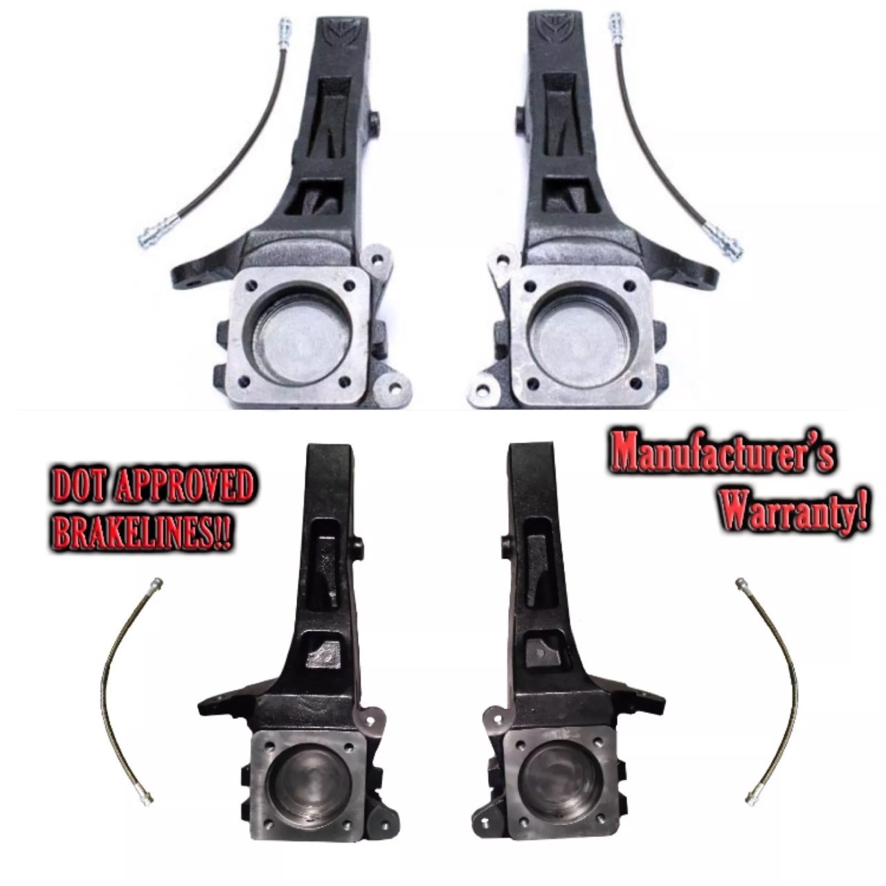

    If they rust so easy what else could be the difference between Maxtrac and some other cheapest options? Some others around $400, let's say!

    Not sure my guess would be the material it’s made with might be cheaper quality?

    Maxtrac top, blank bottom... “look” similar in pics however I can’t speak on how similar they are as I don’t have experience with the blank ones

    Almost guaranteed to be made in the same facility.

    Possibly... just looking at the listings the blanks are coming from Brea and the maxtracs from Anaheim (suspension specialist probably)... @sblspawn are you going to be the one to give it a shot and a review? :thumbsup:

    the maxtracs are only 20 bucks more, I think I would go with a brand name for 20 dollar difference, IMO
