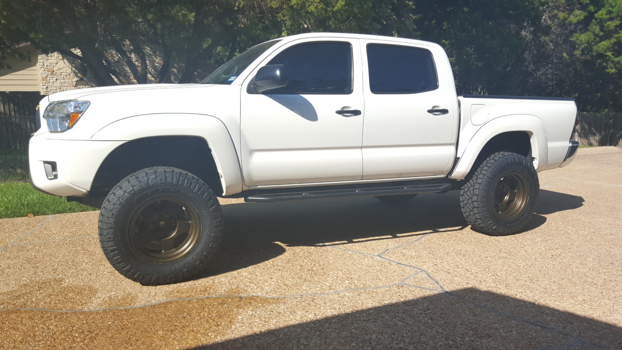

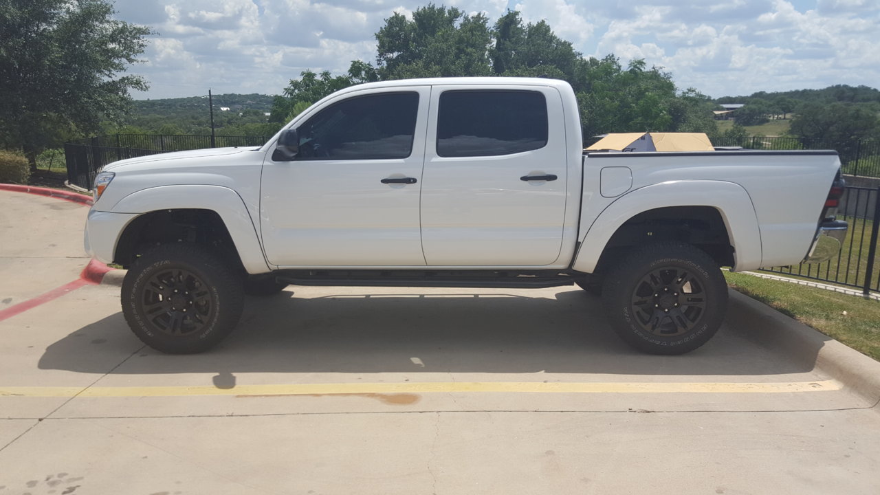

    Thanks Chris! She's my baby :cool:
    Never had a new vehicle and never owned a truck. Always wanted one and it's just the way the cards fell.
    Couldn't be happier to have it and find this place full of enthusiasts
    :cheers:

    Thanks a lot, man! That truck is a beauty! I love how it looks with the 285s. :)

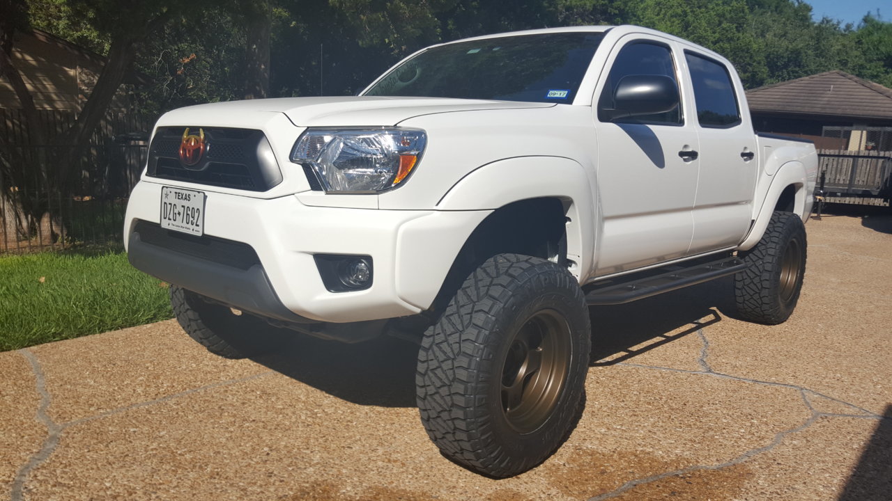

    Before the 285s you had 16" or 17" wheels?
    ChadsPride[QUOTED] likes this.
  8. Aug 7, 2018 at 4:14 AM
    ChadsPride
    Nov 26, 2014
    #143119
    127,312
    Sponsored by TacomaWorld.com
    They were 17x8, had wheel spacers on the back before 285s also.

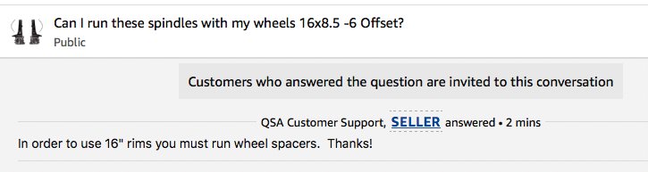

    This is what a seller answered to me on Amazon. :(

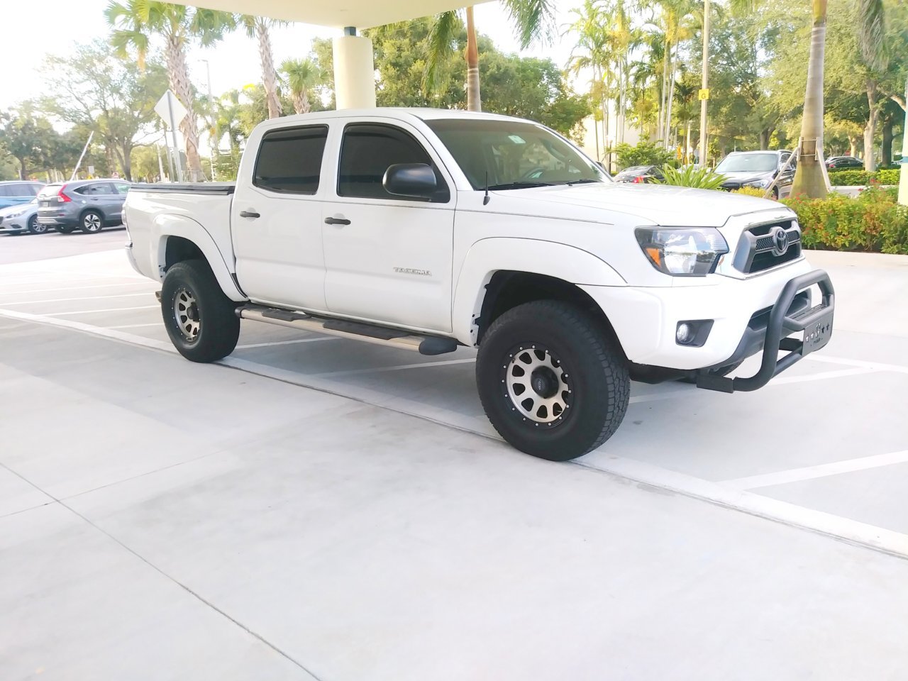

    I have konigs 16" and only spacers in the rear to even it out.

    Looks great, man! What backspace you have in those 16?

    I don't know why but many sellers agree that 16 wont fit without spacers. This is a reply of a Maxtrac seller to the following question:
    "I have a 2015 Tacoma with 16x8.5 wheels (- 6 offset) 4.50 backspace. Can I use my wheels with these spindles? The answer: 17" Minimum Wheel w/ 4.75" Max Backspacing or less" I'm very confused right now! :(
