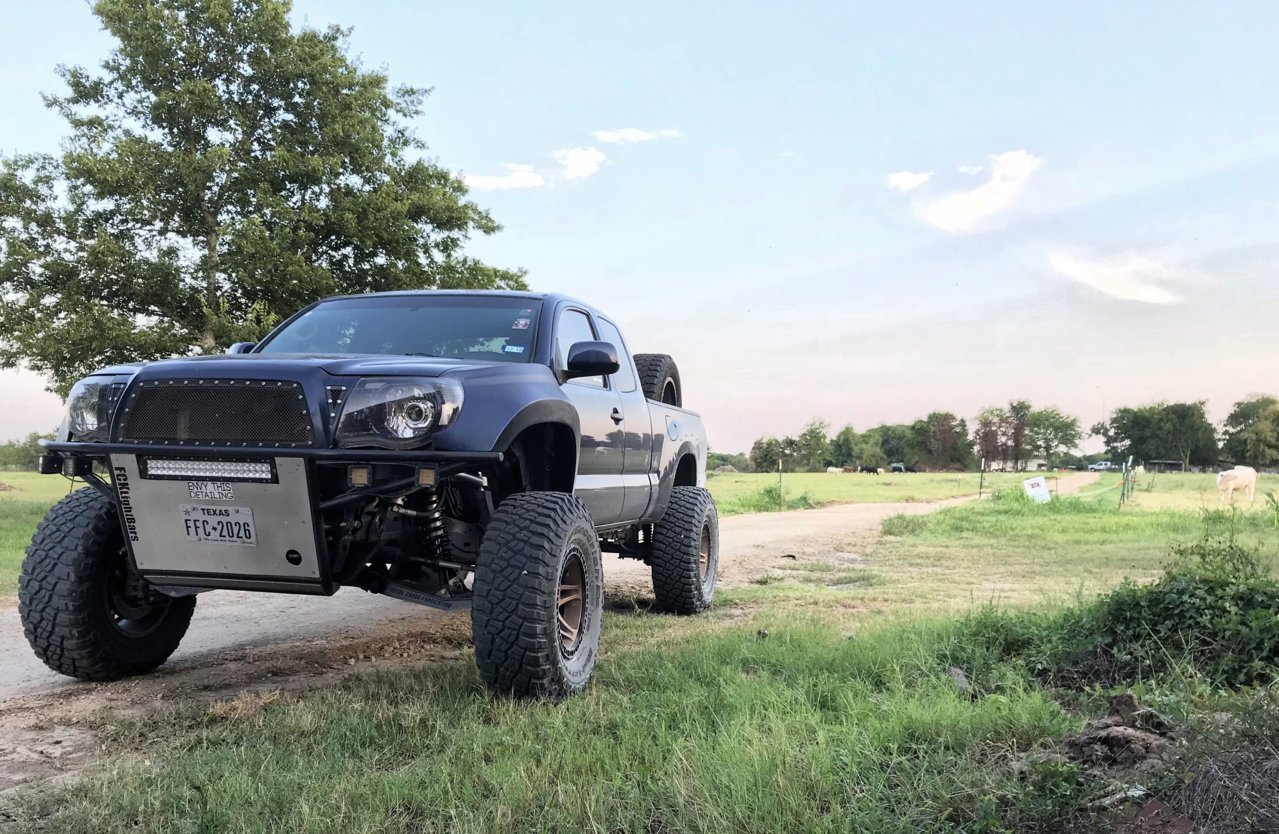

    Did you get the standard kit or the race kit? @1nonlygarcia . Also, just for the sake of argumentation, I have +3.5, spindles and -44 offset wheels and I stick out of +6 fenders . You can run 33s or less without fiberglass fenders, it’s going to stick out really wide but they won’t hit the fender on compression. You can install it and daily drive it without fiberglass fenders. I’d get glass before off-roading though

    Good choice on race kit, because the other one won’t fit Maxtracs. Here’s mine with stock fenders and 35s with spindles and LT. Since 35s fit then 33s or less will be okay too

    You’ll want to go bigger with fenders. Even 35s look a bit small. I’d for sure stick with the 285 until you get fenders though, and wear them out. Then when it’s time for new tires figure out what you like.
