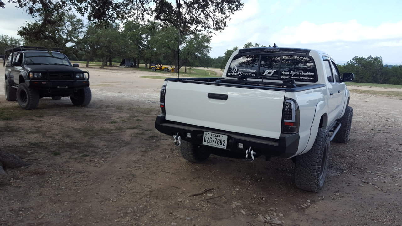

  12. Aug 26, 2018 at 5:53 PM
    ChadsPride
    Nov 26, 2014
    #143119
    127,312
    Sponsored by TacomaWorld.com
    I'm actually not running any on the truck right now. Kinda has a trophy truck look with the front sticking out a little more than the rears.
    Before I got the SCS wheels I ran 1" in the rear. It matched the front and looked good. (They were just off brand that a local member gave me)
    I've recently picked up 2 sets of spidertrax 1.25" (4 total spacers) that I plan to put on when the bumper and coilovers go on next month.
    Should make the poke nice and rediculous :D here she is today

  13. Aug 27, 2018 at 1:10 AM
    Biscuits
    Biscuits Thorny Crown of Entropy
    Aug 8, 2010
    #41397
    15,577
    Swiggity swangin' biggity bangin'
    Bora makes 0.75" spacers, which is what you'll want to use (or at least spacers of that width) to even out the rear wheels with the front.
    -edit- 0.75" is the width delta that I measured on my PreRunner.
