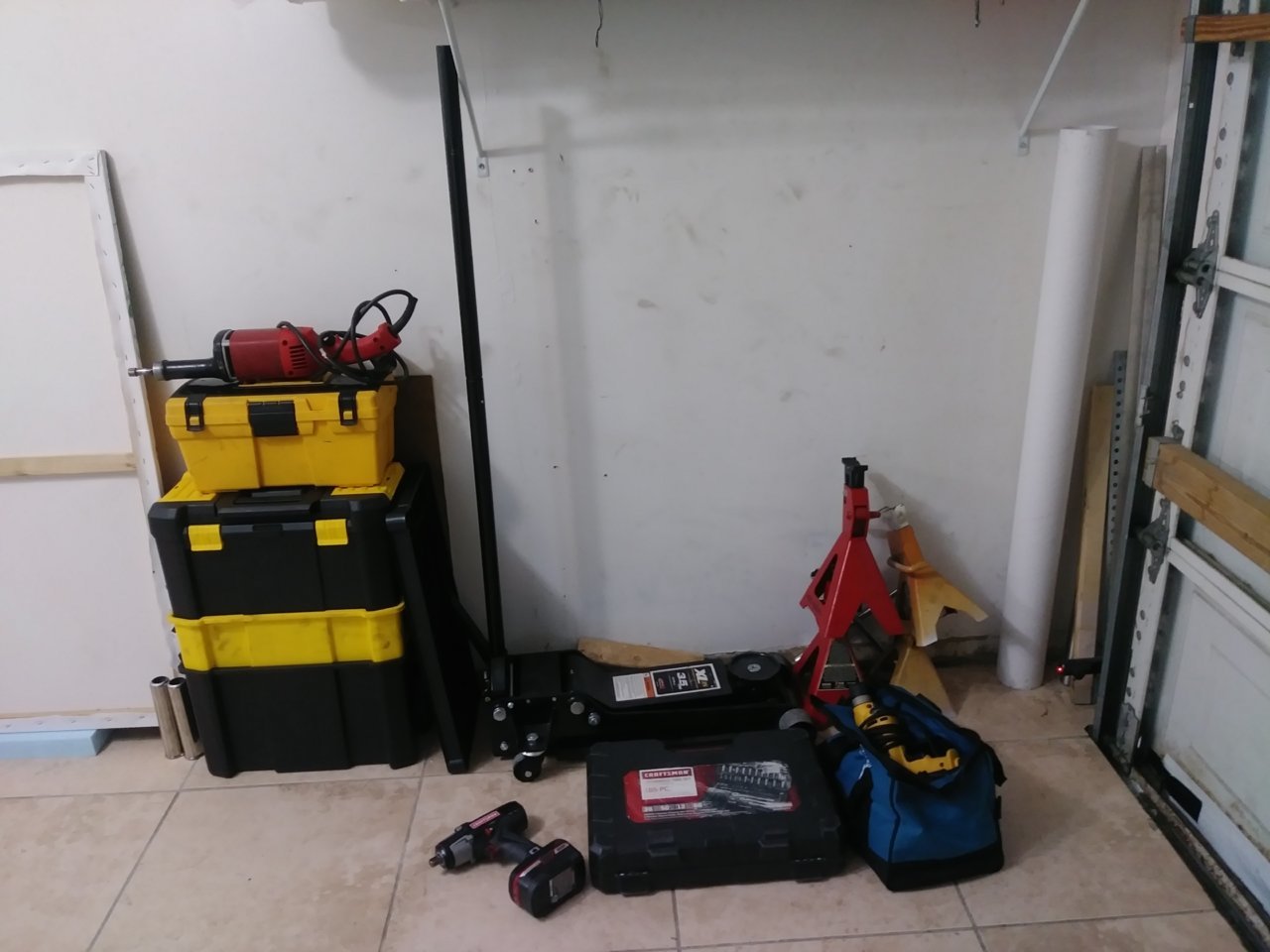

    I got all my shit ready for the weekend! Except for the beer, of course! :)
